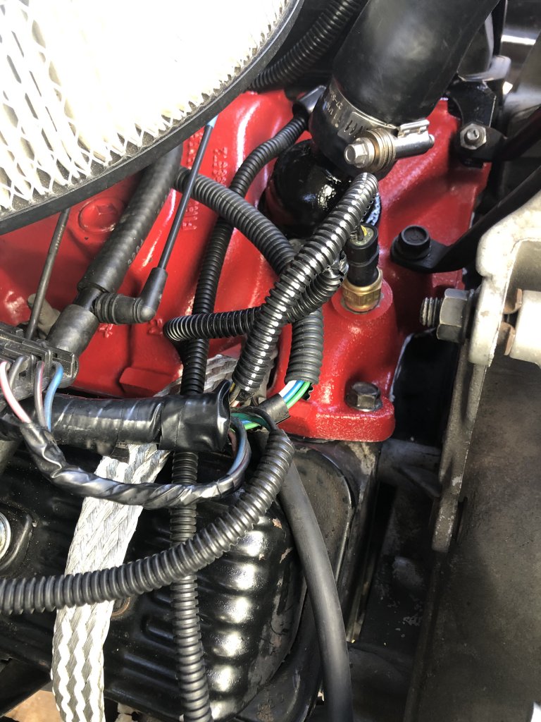

Large ground strap to frame

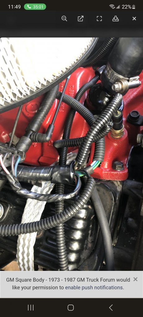

what is this vacuum arrangement? looks like something that should be hooked up to the TBI is Teed into the PCV valve line?

Goes to the canister that was there the whole time
thanks It does connect to the TBI

Rusty Nail EST wire clear thx
Nice build! Looks like you have replaced wiring harness and everything.

Original Harness Wire Mold, wish it would run
