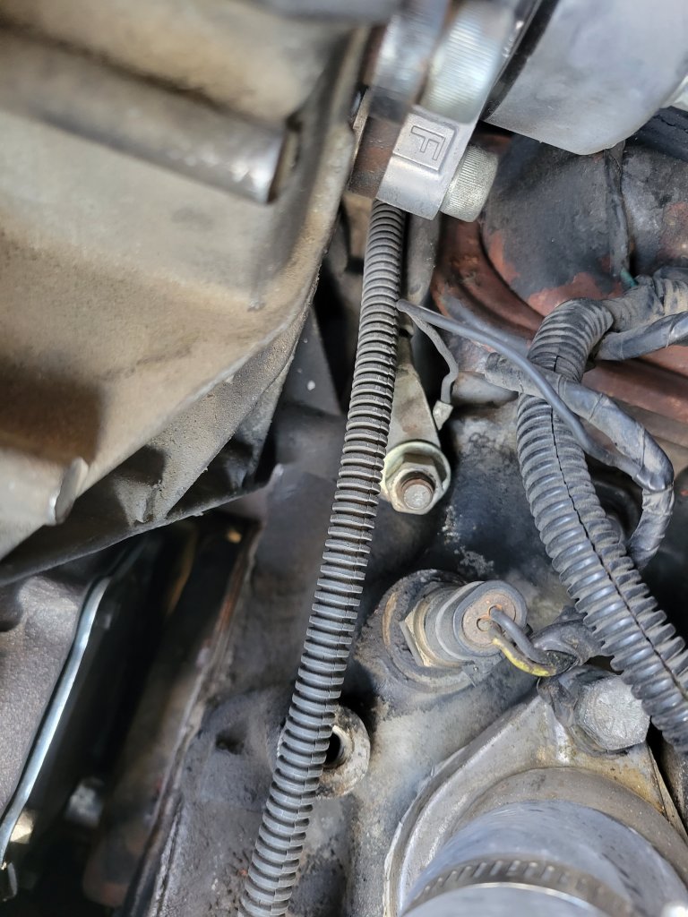

my ground is here next to the Coolant Temperature Sensor

That is Exactly where mine is, I painted the intake and used thread sealer would that be an issue?
Rusty Nail what is your suggesion to locate the Grounds, Battery And small wire ground??
