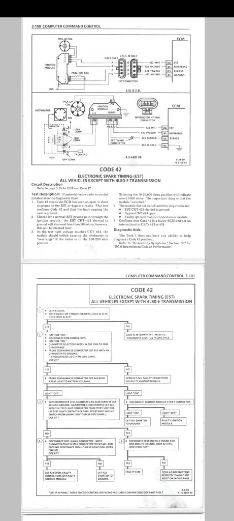

if it wasn't doing it before you replaced the manifold, and is new after, it is likely something that got touched somehow. I'd guess the issue to be in the ICM harness in the EST wire or one of the 2 reference wires. the issue could be in the wire or the connectors themselves. did you go through this diagnostic for the code 42?

In the Process Now
