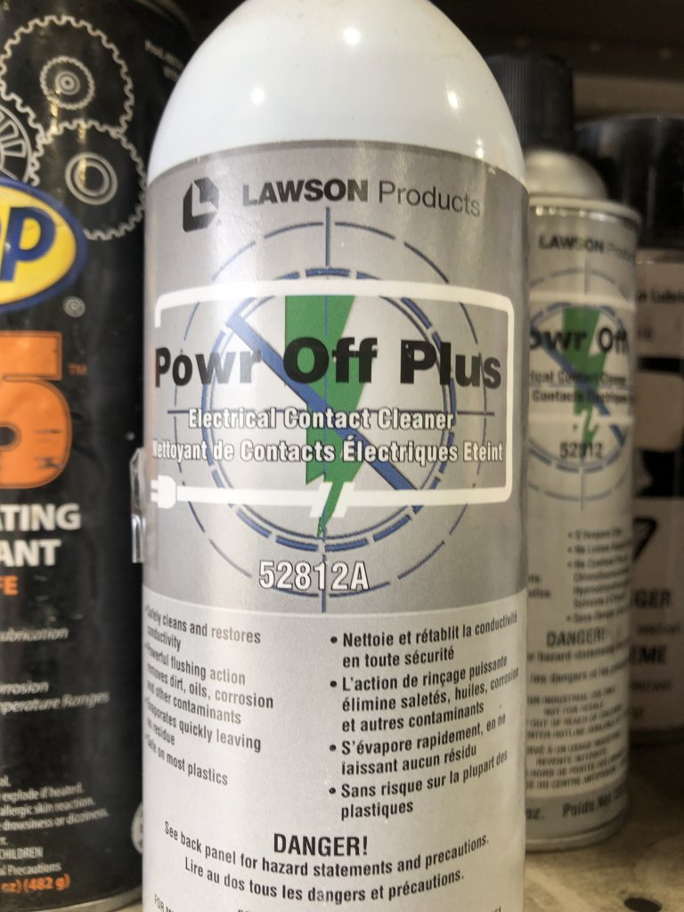

PROGRESS: Removed the Distributor, ICM was loose, checked wires, Disconnected the ICM Plug Wires, Blasted it with electrical contact cleaner , and the Tan Brown connection used to set Timing.
Went for a few short drives, No Engine light, No Stalling!
