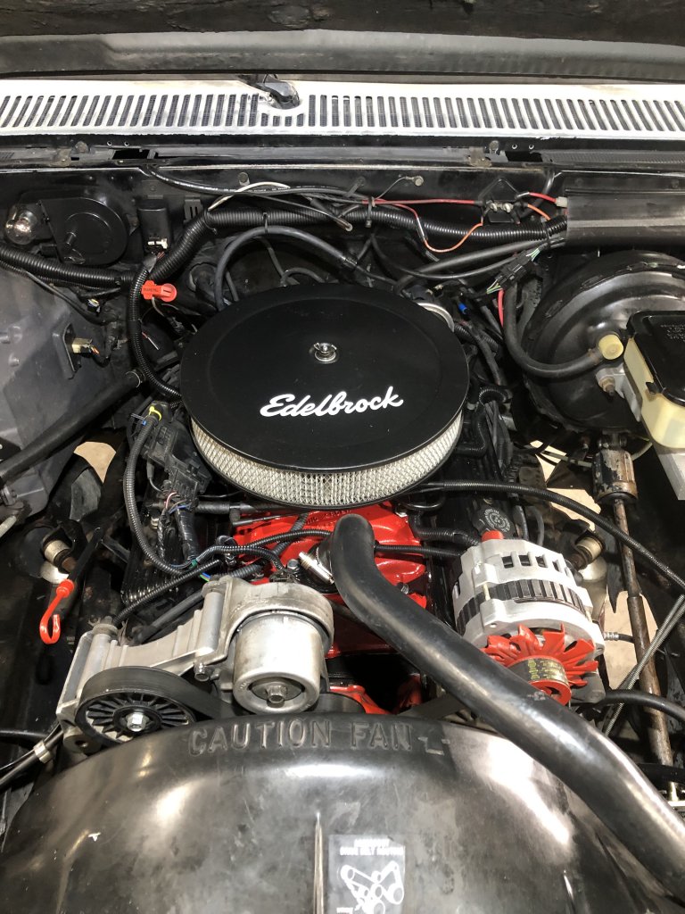

Well its done had to re set the timing no big deal
Now it has low idle and when revving the engine at operating temp it stalls, hard starts, Code 22 TPS gone bad?? It was fine before? did the throttle body cleaner damage it when i blasted it? Also Bent Kinked fuel Line trying to remove, not bad no leak, would this be part of the issue Driver side Line also did not have it complete plug in just resting on top probably shorted out??

Well its done have not started the engine yet draining the oil over night, however kinked the right fuel line during removal, not too bad but what could go wrong???
Everything and, nothing.

Latest cleaned the electrical connections on the TPS and cleared the ECM codes gone? Went for a test drive engine light came on hard shift ran like it was going to stall!
Checked codes now code 42 came up just replaced the ICM in June Checked the wires all looked good, Cleared the ECM again started the engine let it idle and it stalled out
Re start very hard then idle was very low reved it up and stalled No CODES Help?!
