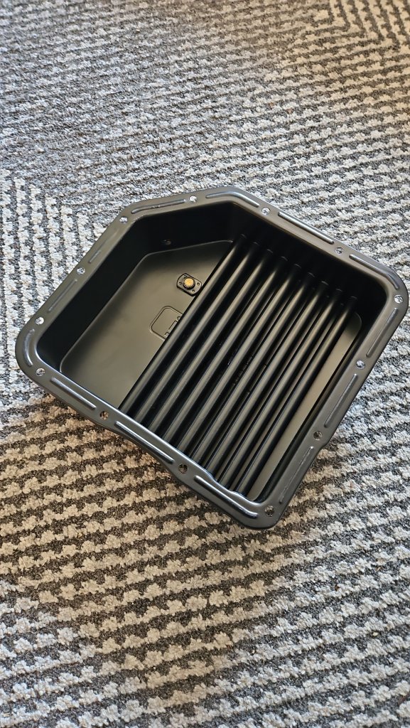

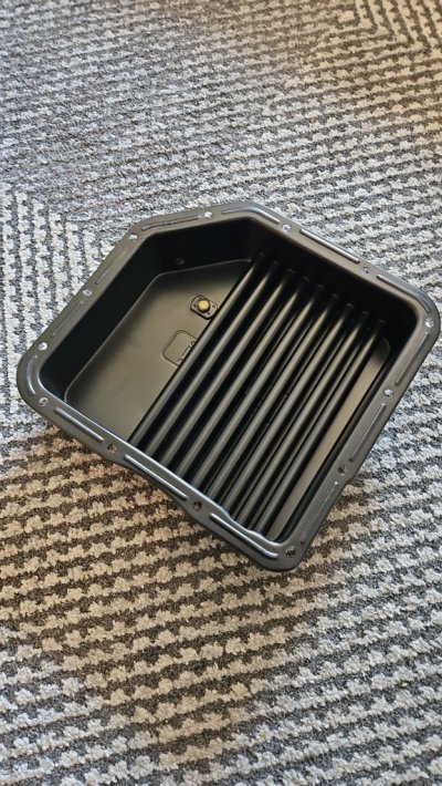

So anywho, I bopped out to Summit and prused the "demo" isle. Low and behold there on the shelf was a TH350 oil pan of a fancy design. Yep it followed me home. Now the only reason I nabbed it was becsuse the original was pretty badly rusted. And I got a new engine oil pan last fall. It will be going on when I pull the motor.

Those pans with the cooling fins work well, but are a pain in the ass to clean. All the clutch debris collects under those tubes where you can’t get to it.

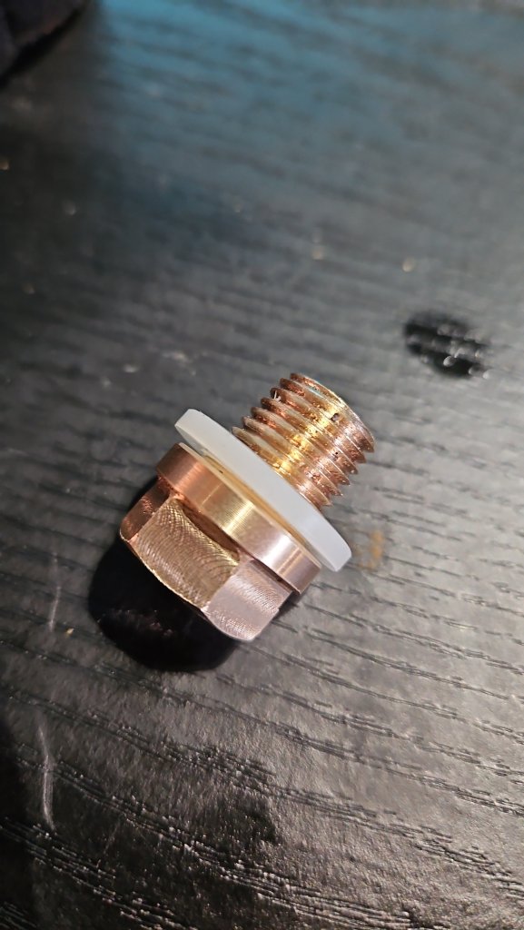

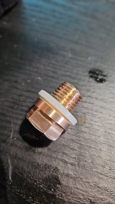

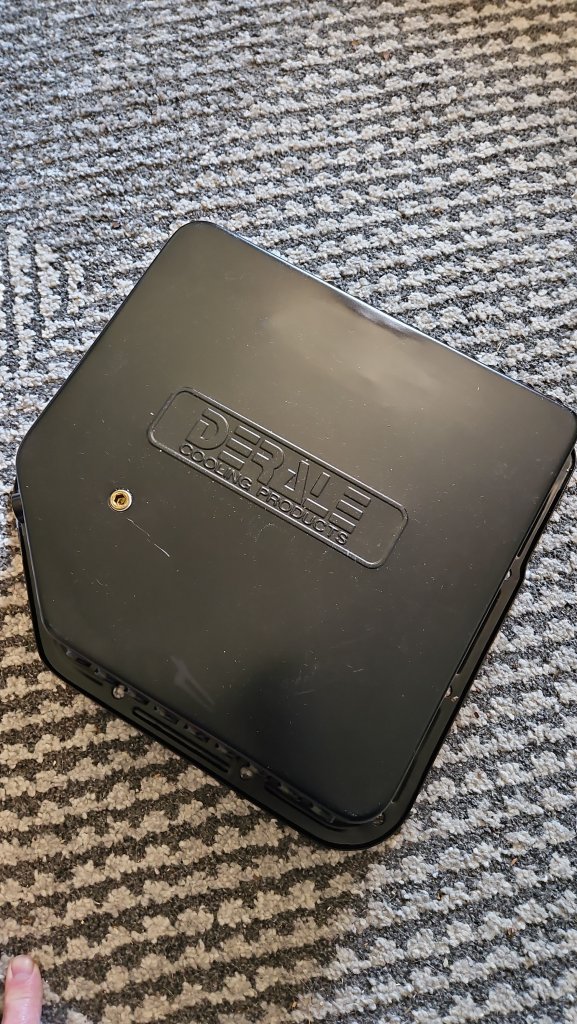

However, while I was there, I found a tranny pan with cooling tubes and holds an extra 2 quarts. Normally, it would run ya $210. but it was in the "returned/demo" rack. It was slightly damaged around the flange. It was very easy to straighten the bends with a small rubber mallet. The only other issue was there was no threaded plugs for the 2 holes. (1 for temp and 1 for drain.) No big deal. I had the 1/16" pipe plug but had to make the 1/8" flanged plug and gasket.

I like those pans; you can clean them in the hot tank or power wash them if need be, will get them very clean.
