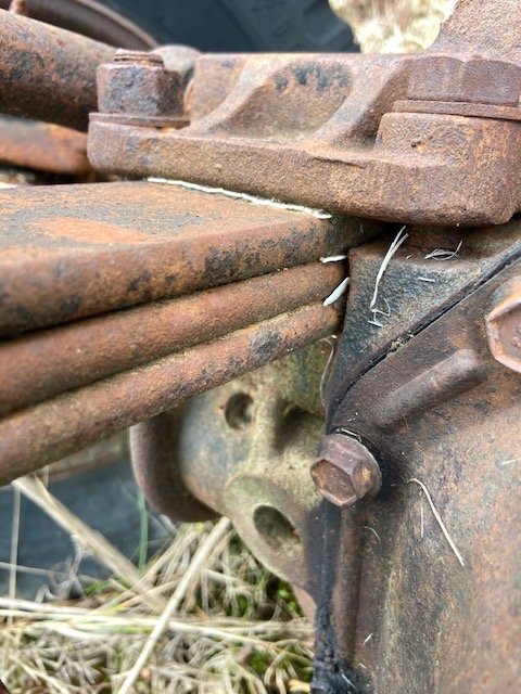

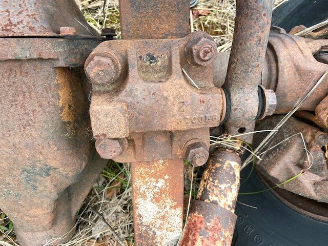

Remember that a GM Dana 60 only uses 3 u-bolts to hold it to the springs. The inner side by the pumpkin should have two studs or bolts.
Ok, he does have the springs also sounds like I should get that to

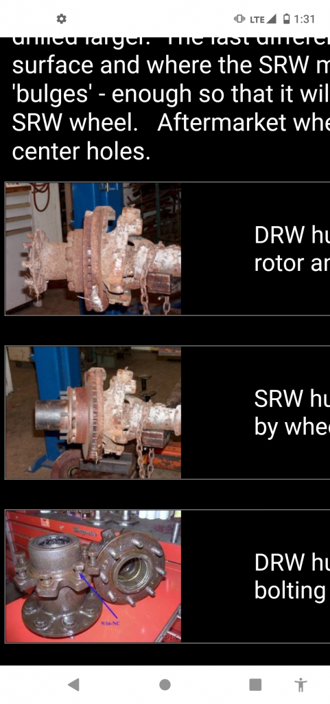

yessir, the front axle from dually is only wider with the dually style wheel hubs on it, you can put single rear wheel hubs on them and it will be the same as any single wheel squarebody.
if you look at the screen shot you can see where the wheel bolts on and notice the difference in wheel hubs
edited to include: the housing is the same from SRW to DRW it is only the wheel hubs that make the DRW front diff wider.

Wow I would have never known that, interesting for sure thanks
