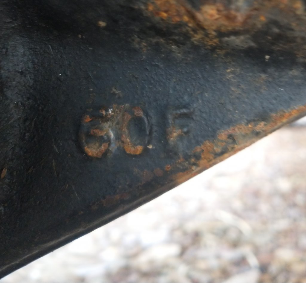

clean off the gunk in here, it will say 60 if its a dana 60
edited: to include pic of dana 60 marking

lol well I had no idea I was taking the right pics, that’s awesome thank you… the Dana 60 I’m looking at on Sunday would be an upgrade then? I checked the ratio on this dana44 and it’s the same as the dana60, 4.10
