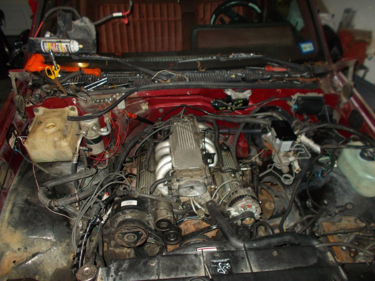

Wiring is about half installed. Need to finish that and finish the fuel system (extend lines and install pump) and it should be ready to fire up.

Nice work :waytogo:
31,376
31,123
It's going to be awesome! GM should have used TPI in the trucks to begin with.

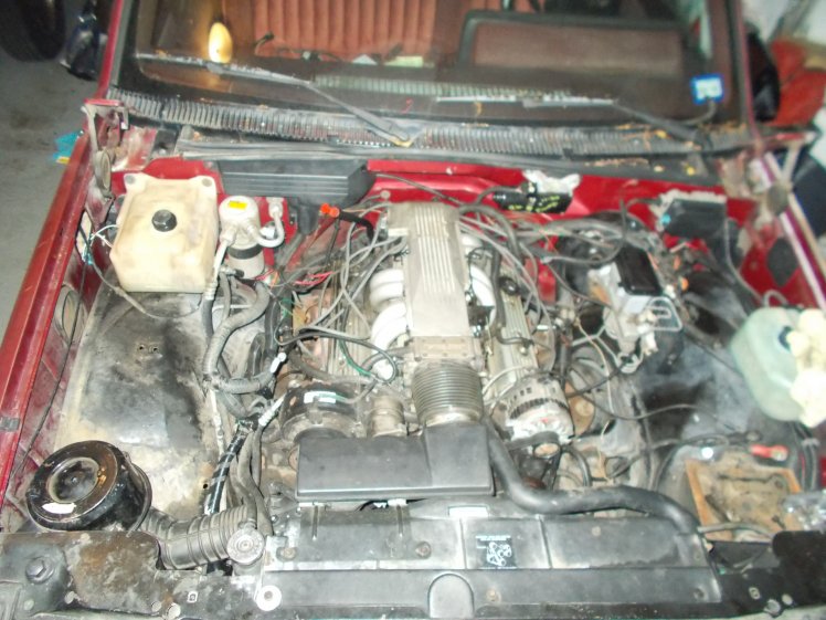

About another hour's worth of work and i get to seen how badly I've screwed it up.

Looks like a factory install from here. What rear gears are in the truck?

3.08 open. Considering that many 350 F bodies had 2.73s...But I will change it at some point, probably when I do rear discs.
Up close you can see that it's not factory, but close enough. It's not a hack job like the 1995 K1500 Viktor got recently.

A 3.73 would be really nice, so would a 3.42 really.

Looks nice, that 1995 was a hacked install for sure, but I undid all of it. I wish I kept the tbi unit to throw back on it.
The first gear in a 700r4 does not need anything taller than a 3.23 or 3.42 in the back. My 85 with cheaper tires would spin 1st through 2nd with 3.08 with any moderate throttle after 700r4 swap. And a lighter 89 trans am would do same with 2.73's in the back.
