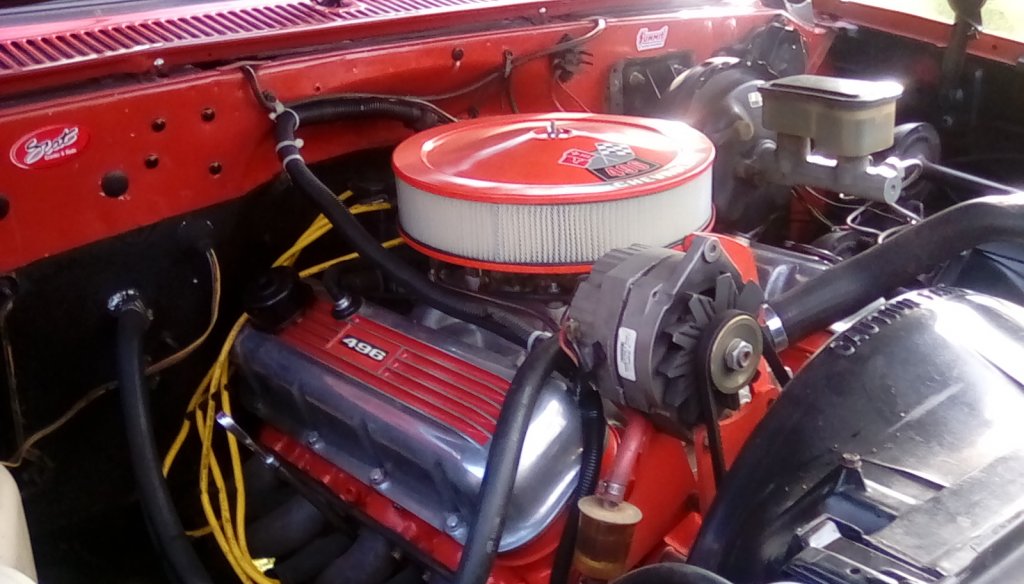

I do have the Hots for more cubes ..
Have located a 4-bolt main block ...
Be a long while before I'll be able to afford this rotating assembly ...
Takes the cubes up to 496 inches ...
That's with a 0.060" over bore ...
