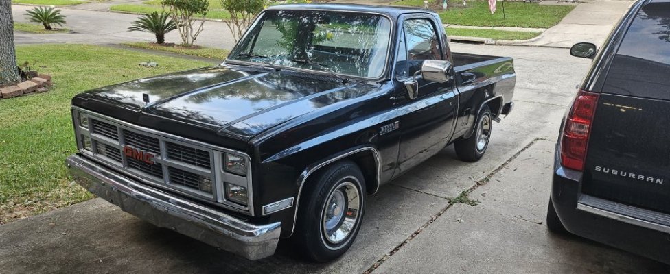

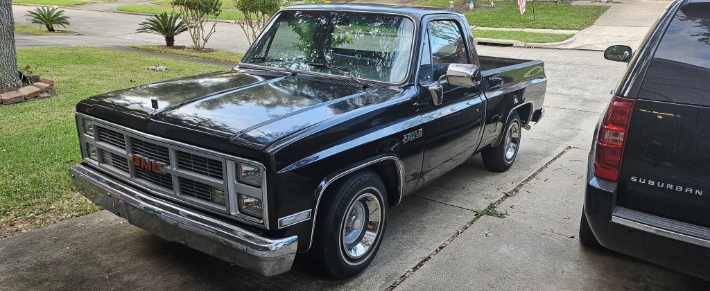

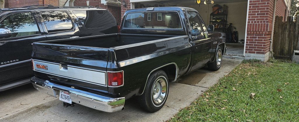

Finished installing fender badges and dash badge. Officially showing GMC rep now!

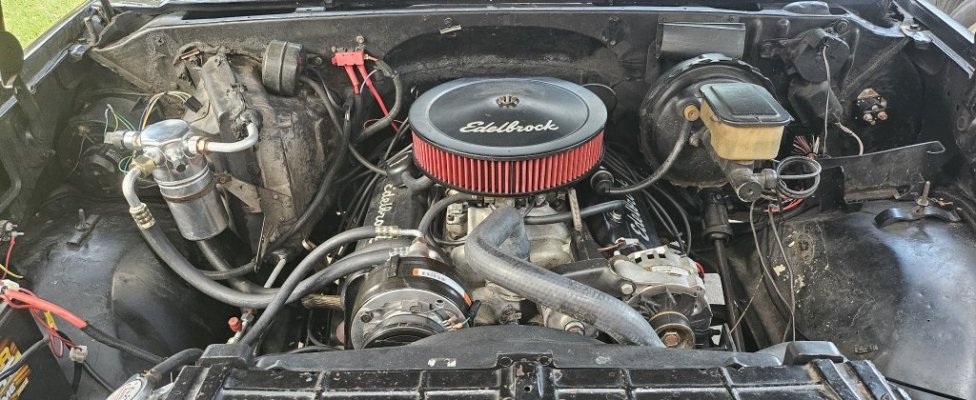

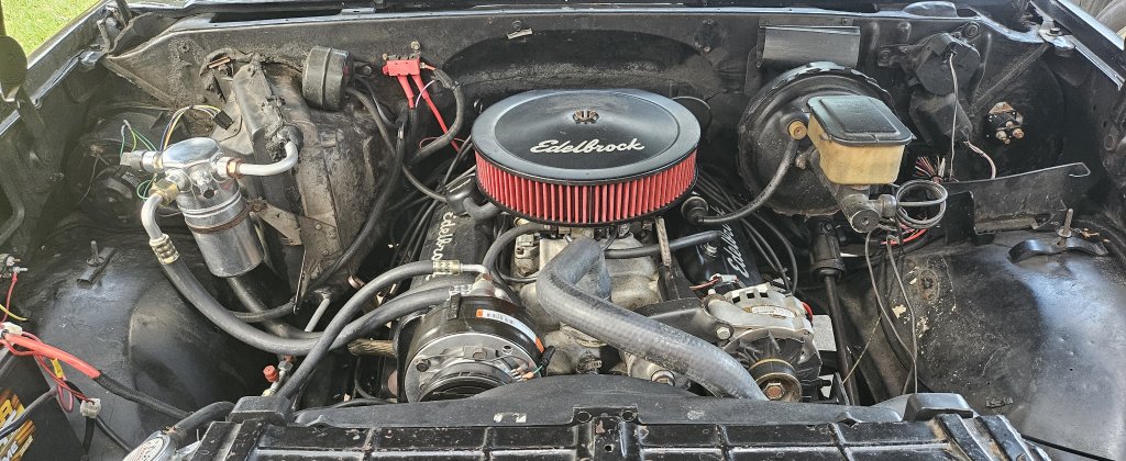

Also bonus pic of engine. Still struggling with AC freon not flowing through orifice tube properly and freezing up. May just give up and take it to a shop at some point. Will be the first time this truck sees a shop outside an alignment in over a decade.
Is the low side pressure switch doing it's job? If it's not cutting the compressor off when the low side pressure drops too low, it'll tend to freeze over.
It's a new switch. Is there a way to test it?
When filling it up, it does cycle until it has more freon. Then it freezes up at the expansion valve but remains cool (not remotely cold) on the drier.
Pressures also tend to be high in high side relative to where it should be compared to low side
