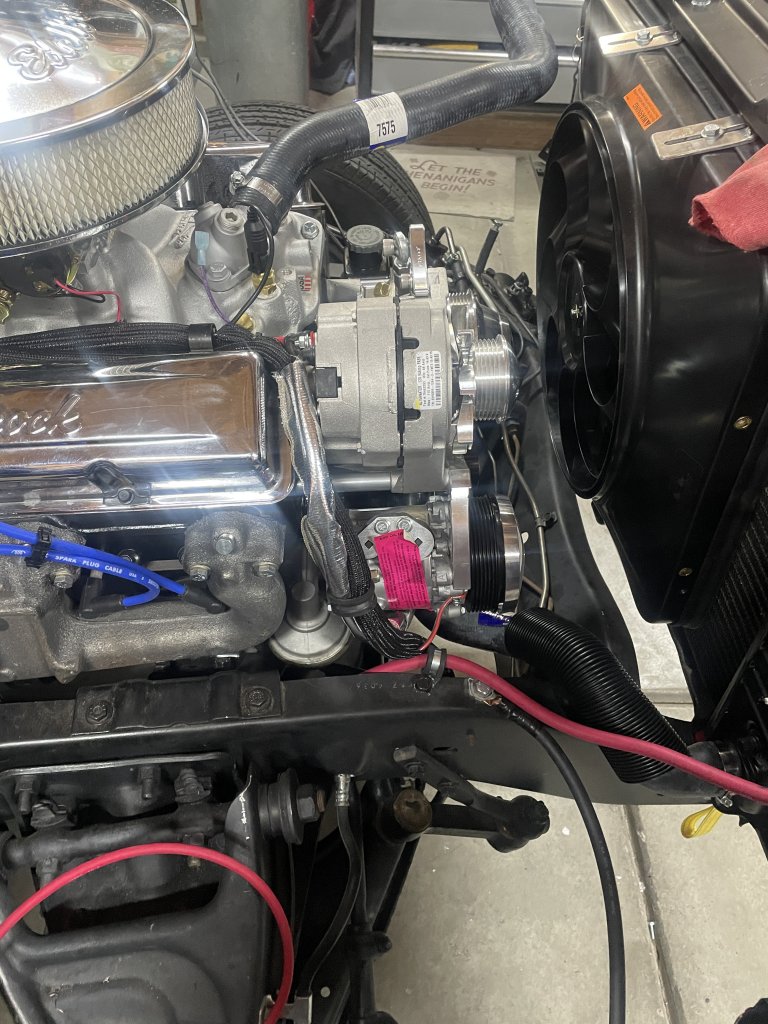

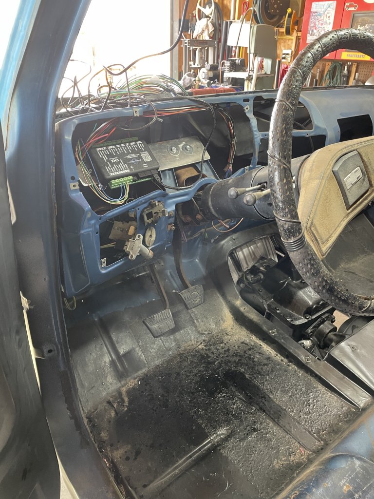

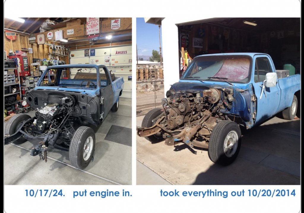

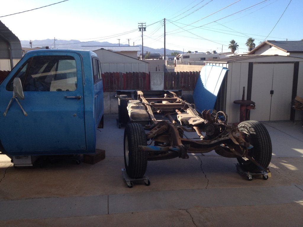

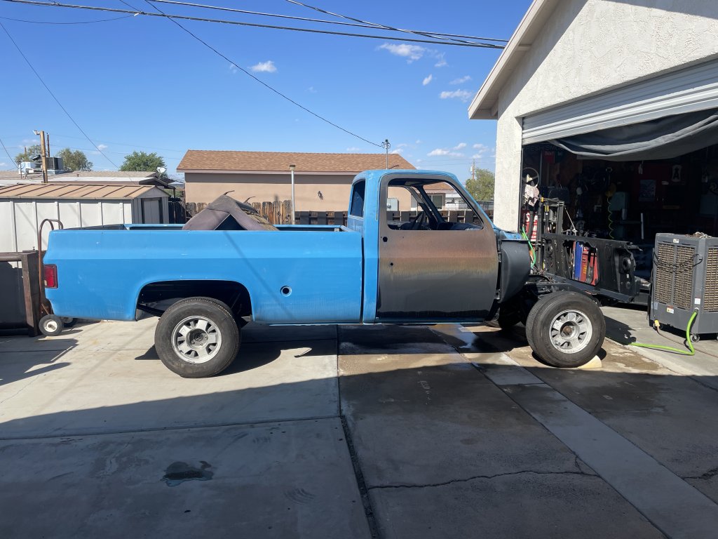

Just got it running after 10 years! Lots left to do
