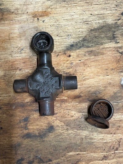

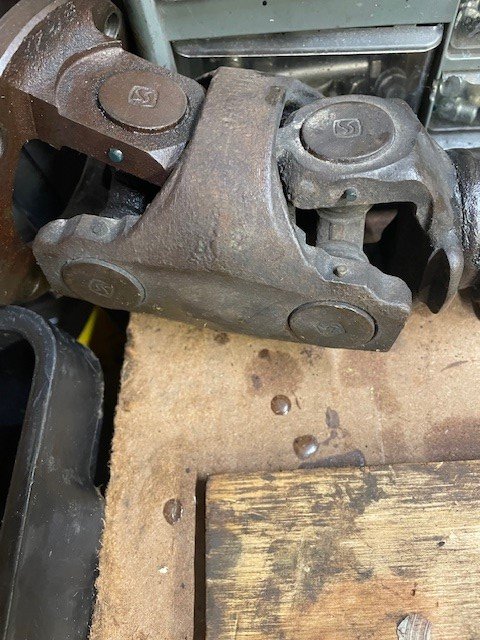

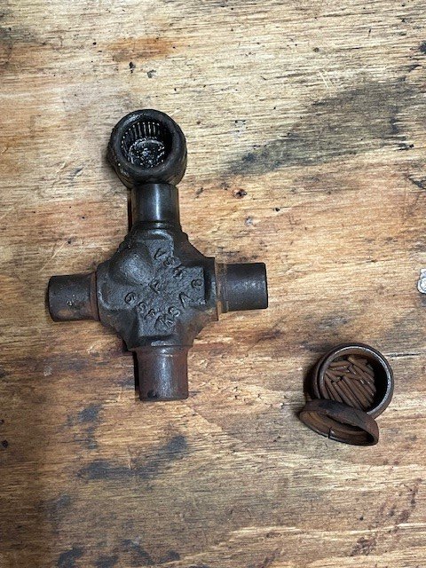

It looks like the front drive shaft still has the OEM joints. The rear cardon for sure, note the plastic **** sticking out. The front one three of the 4 were a pile of rust. It's amazing one still had some grease in it. I'm going to try and rebuild it. It looks like the slide has a seal. I don't find it when looking for parts. How difficult is it to rebuild the CV joint? Next, it's on to the rear brakes, and an installing a lunch box locker that I've had for a year.

There is the centering ball to deal with, but otherwise just like other U joint jobs. Mark everything before tear down to keep phasing correct.

Awesome thanks. The CV joint still moves fairly smooth, you can still feel the spring force it back in place. I'm hoping the ball is ok, and just the u joints need to be replaced. I'll buy the kit any way. Have you seen the seal on the sliding yoke for sale any where ?

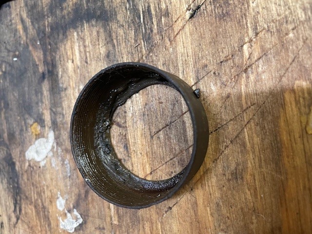

I found a listing for the slip yoke seals. They are called dust boots they are a Spicer part. Northern Drive Train carries them. Now to find the correct one.

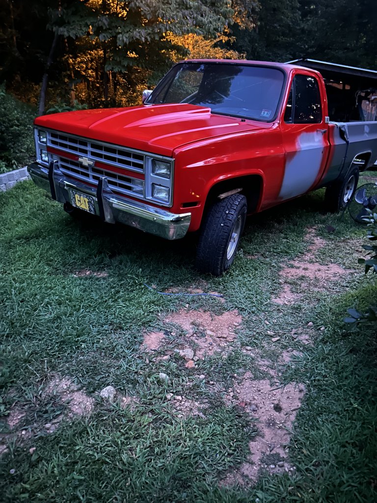

It’s a bit like putting lipstick on a pig but I got one side done.

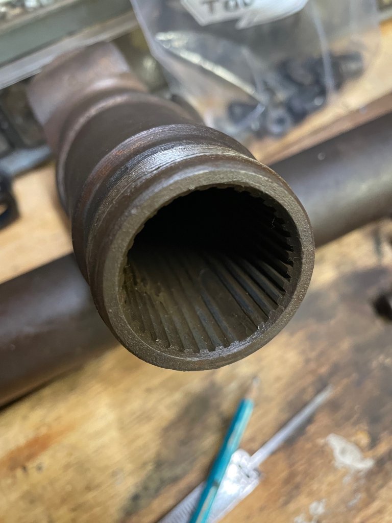

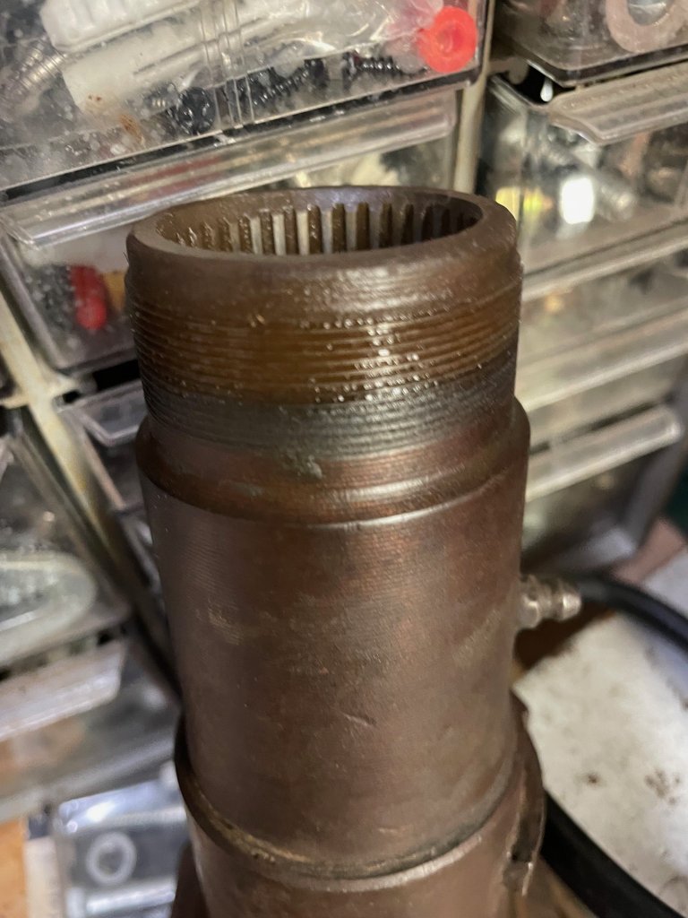

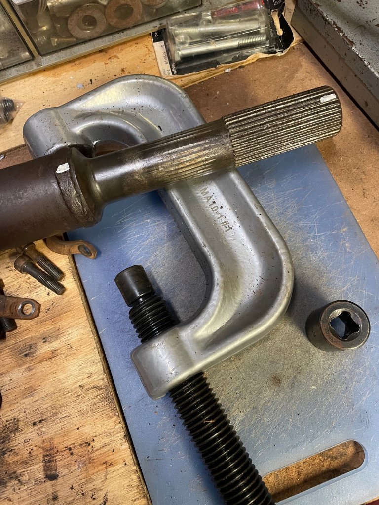

Ordered my dust seal for the slip yoke. The splines look ok. I have always kept this greased over the years. The shafts are keyed just like the transmission, with one larger spline. just as I had guessed there was no sign of a seal. It must have deteriorated years ago. See the link below. The u joints, ball, spring kit, and dust seal should be here in time for a weekend project. I'm going to clean and paint the front shaft.

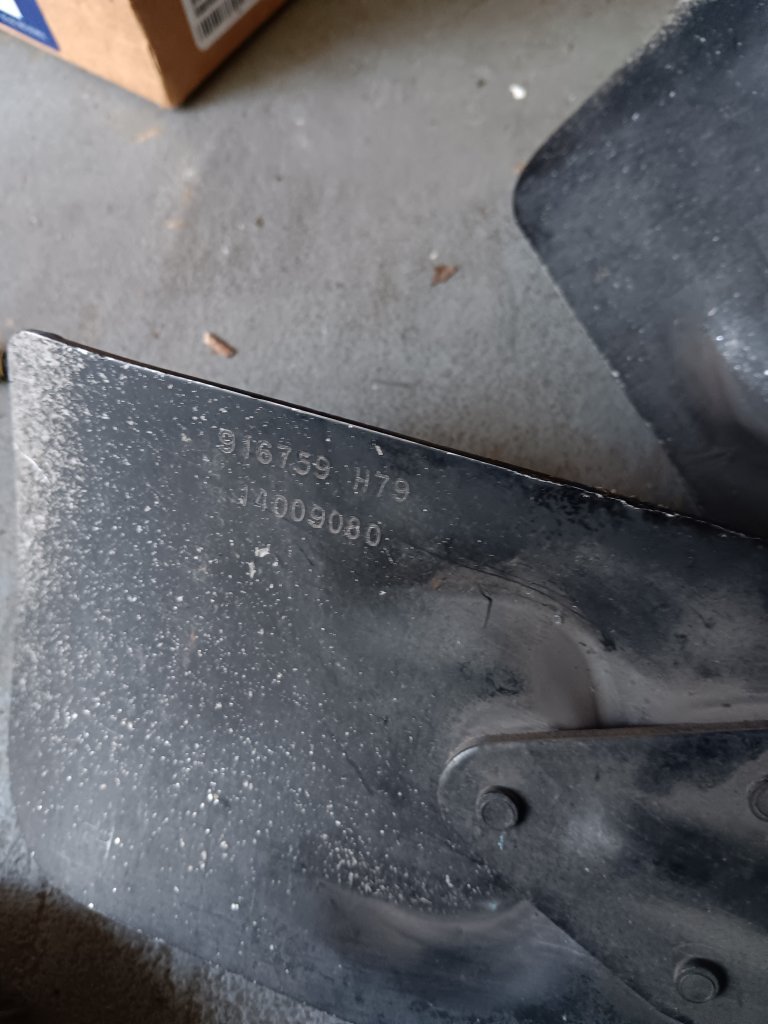

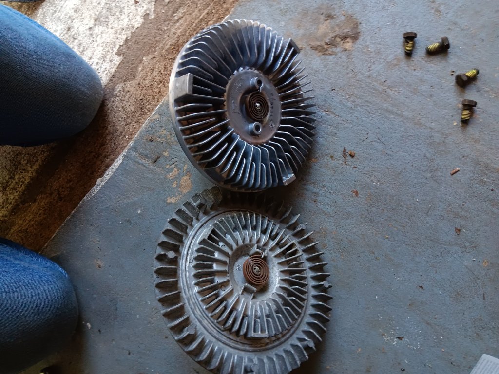

I noticed my fan clutch has been hanging on and a slow warm up. I did some reading last night and found I needed a severe duty as that was the stock clutch versus the heavy duty I had. Hayden 215045 is the stock clutch for an 80 with AC.
Also found that Murray 2797 is the cross and OReallys had one.
So, in it went.
OE 5 bladed fan P/N pic for reference if needed.
Severe duty clutch is the upper one.
