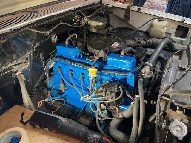

I think I fixed my thermostat housing leak. It's leaked slightly since I got "Ralph". I tore it apart a year or so ago, but it did not fix it. It was just enough to lose a quart or two every month. A few weeks ago, I noticed the rad was full!. And the cap "popped" when opened. Checked it before I drove into the Rockies today, and it was full. I've been driving it alot and well, its not loosing coolant any more. Huh. See, like I say below, my truck is getting better! This is an original motor, that has never been apart. 43 years old. Only maybe 95000 miles. I gave it the Vice Grip Garage (spray can) rebuild. Treat her right, and they'll respect you. Motor is now dry below the T/S housing.
