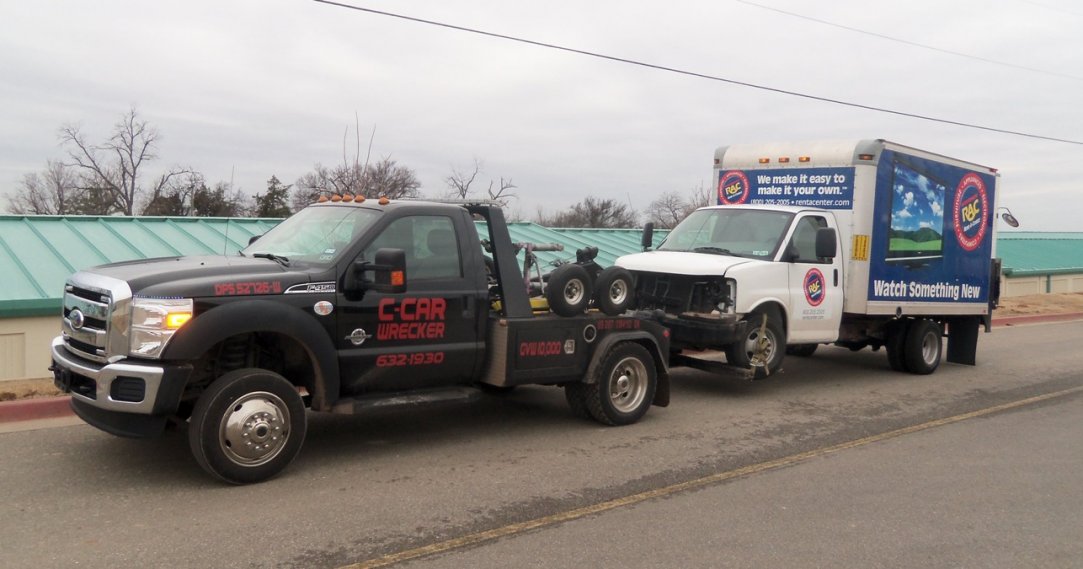

At least you're paid hourly.
I had to pull a box van the other day for a 22 mile tow. Think I pulled a driveshaft? Hellllllllll No. Checked the glove box, seen a GT4 and didn't see a G80. That told me I only had to remove 1 floating axle, not 2. Used my star bar and 8 bolts later pulled the axle. Taped a plastic bag around the hub to keep dirt out and catch any slinging oil. It lost about 4 tablespoons of oil. Gotts love full floating axles.

True enough on the Hourly pay. Honestly I don't have a lot of experience with disabling drivelines. I was taught to just take them loose at the rear u-jont, tape the caps and bungie it up out of the way. It just surprised me that the spline joint slipped apart so easily but absolutely did not want to go back together. I still don't get the logic of the Locktite on the spines. Oh well.
