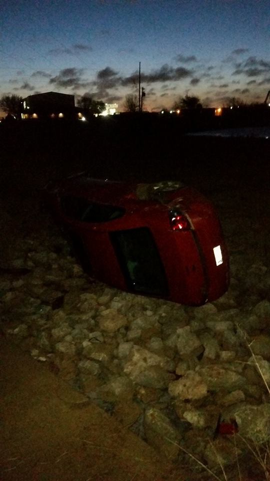

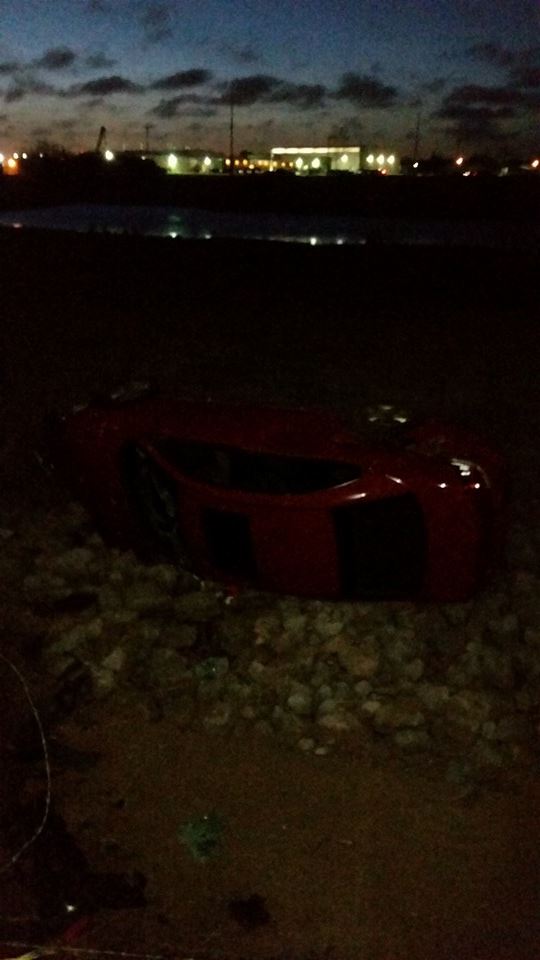

Do be careful THINKING YOU KNOW an area. I got the same call last weekend. It's only 20 feet off the pavement. Cool, no problem, I'm on my way. Here's what I see when I get there. A $55 Agero winch out right??? NOOOOOOOOOOOO WAY IN HELL. I got the GOA, told the customer he prolly needs a police report since he has full coverage insurance. He called USAA, they didn't want the police involved because there was other county property damaged that would be claimed if police got involved. So he gives USAA adjuster my # from when I was out there. I told the adjuster it's a $600-$800 recovery of Law Enforcement was to call me on it depending on how quick we got it and how many men. He asked if I'd be willing to quote him a price to go get it. I said sure, now that you asked, but it's illegal for me to solicit, so now that you asked me for a quote, I'll do it for $500. Done deal, go get it !!! Took me an hour to get it. So 45 minutes drive time, an hour of labor..... you see where I went with that. But I knew this location too and knew it couldn't be that bad. ******** !!! That boy caught some air for about 50 feet rolled and landed on it's side in a creek bed about 80 - 90 feet from pavement. This call came in at about 5:10am.

:happy175: Well, bossman is part right. You always prepare for the worst and take what you need for the worst. Sadly, many times you hope for the worst too since that's how you make money. I was totally caught off guard on the above 20 feet from the pavement needing a winch out. Needless to say, I was given bad info from the motorclub dispatcher when I took the call.
