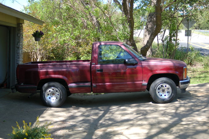

Sierra got a new set of 4" FMPs. :D
These wheels have been passed around GMSB like the clap.:gr_grin:

28,620
10,008
They look good :)
Are those the ones I had Old77 pick up for me in MO, and then I sold to Frank?
28,620
10,008
Poor squarebody rims getting passed around like the **** at high school prom.....They do look a million times better than they did when I handed them over to Jake :D
31,655
31,885
Ya'll only had one ****?
28,620
10,008
We had many but none worth comparing to polished up square body wheels :D
