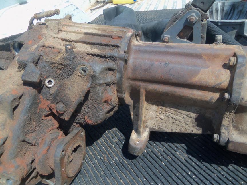

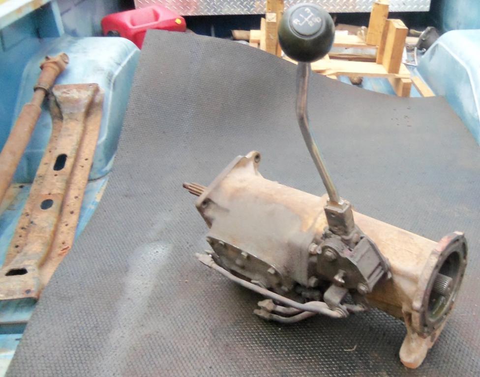

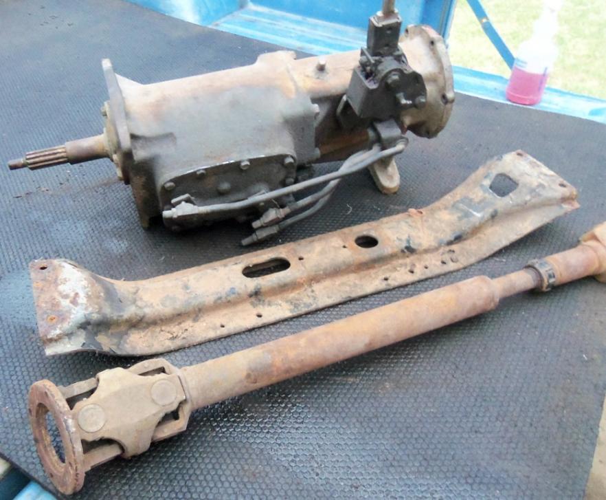

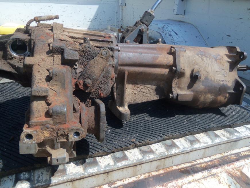

Just hosting some A833 pics to show a guy. Looks like I'm buying an OEM skid plate for this set up for $10 and shipping. Prolly $20 total.

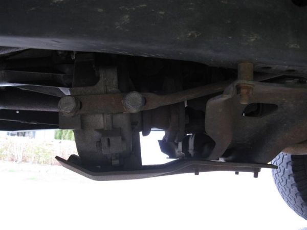

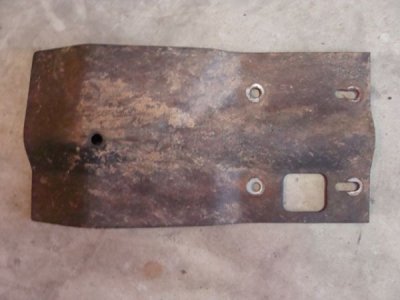

So here's what I found from one of my older forum buds on another forum when I was sending him a message asking his Tug Squarebody and checked into his recent posts. He's selling a skid plate for the same crossmember that I'm using for the NP A833 for $10 & shipping. I'm thinking it should also work when I swap to NP205 too.

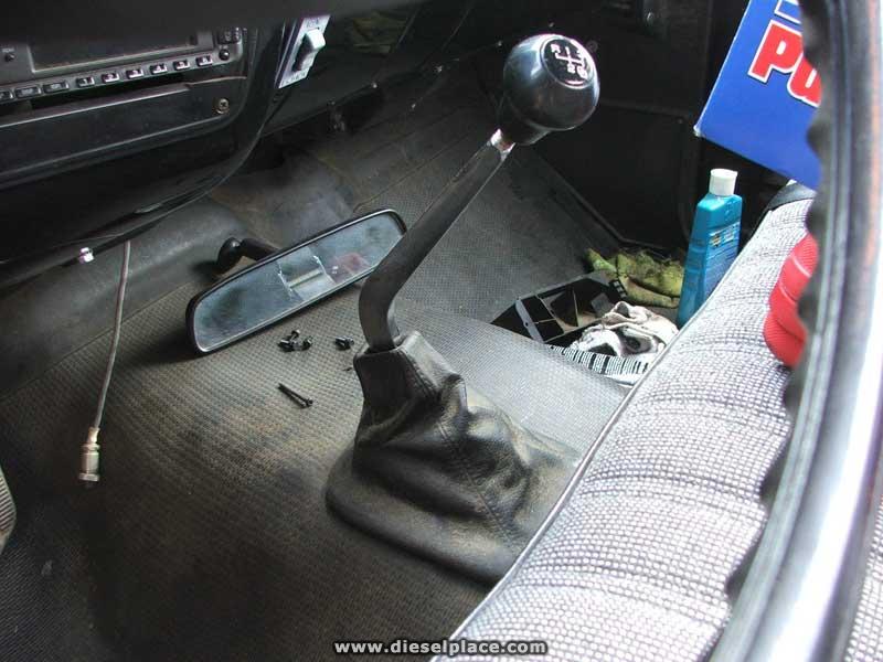

Was reading through the posts, found this one. I have an '85 C10 Scottsdale that was one owner truck (pretty much still one owner, it was my in-laws truck) that has this transmission. I'll have to check the RPO code for the transmission. I want to say that I read somewhere that the MM7 was for the Muncie and the MY6 was the NP833 transmission.
The truck is a very odd individual that I would personally call a 1 of 1 truck. 6.2 Diesel, 4 speed manual, 3.23 gearing, power windows, power doorlocks, air, cruise, delay wipers, cloth seat, rubber mat, factory bed rails a very odd truck. Here's a pic of the shifter. Oh and to ease a little more, I have over 211k miles on it, mostly hwy driving but still shifts good. Only drawback is the throws on the shifter are....just wow all I can say but then again I am used to a T56 6-speed in my Trans Am haha.

I"m wondering if your Hurst Shifter might need a rebuild Billy. You can buy a kit to do it yourself for about $100, or send it to Hurst and they do it for about $250. Or just buy a Hurts Comp Plus shifter, which I might end up **** myself. Just have to get the Hurst Comp Plus for a Dodge, not a Chevy. The Chevy A833 kept the Dodge shifter bolt on pattern according to some reading I did. That might fix up the throw a little bit. And yes, it is a long stick, so that will make the throw longer too.
What axle do you have in this truck that it has a 3.23 gear ratio? You sure it's not 3.08? I don't beleive 3.23 is availalbe in GM 10 Bolts. And it's not a 1 only truck. The A833 is actually more common in the 6.2 tucks than the Gas trucks for those few trucks that did get it.

It's possible that it's a 3.08 I would have to check the RPO codes to see what it lists, I do know it has the G60 limited slip code but it's been a while since I really looked at the codes.
A tree decided to make a place on the truck and I have it tore down right now putting a new cab and bed on it, I'll check it this weekend to see and let you know.
Just glad to know it's not an oddball transmission that would be hard to find parts for now. Very informative thread

Just looked and it is a 3.08 with the G80 option. The code I have on my tranny is MM7
