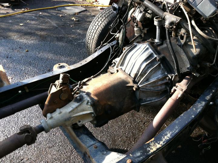

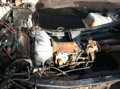

Sorry it took so long to get the pics, but here they are.
Cast iron, with an aluminum bellhousing, go figure that.

Thanks for the pics Billy. I have a funny feeling that was originally a 4x4 unit and then someone swapped the 2x4 aluminum tailshaft housing on it. That's exactly that my gear box looks like.

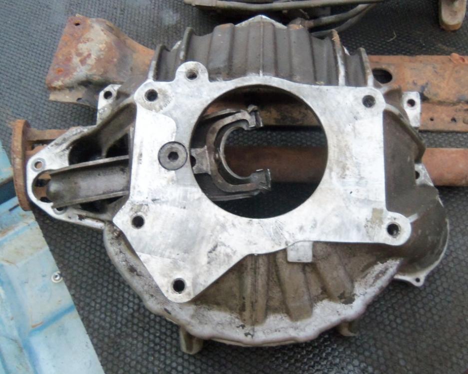

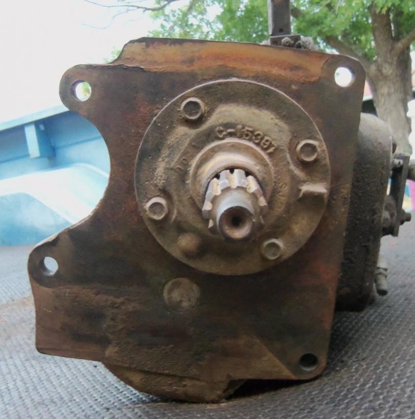

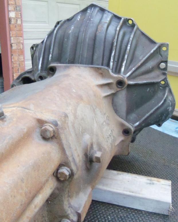

Here are pics of my Cast Iron Trans and Aluminum Bell Housing. The bell housing came off an 87 K10 that had a SM465 and the guy converted it to NV4500, so the dual pattern bell housing is out there. If I had to guess, probably in the 83 and later trucks with Hydro clutch, but there is such thing as a Z bar manual linkage dual pattern bell housing too. I've got a pic of it posted in this thread too.

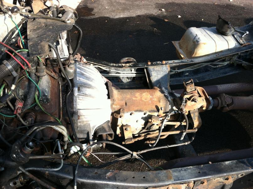

Thanks for posting this up. I might even need a better close up of the gear shift linkage. The dipshit I got the trans from had put the linkage on way wrong. He didn't realize this til I told him the trans was jambed up. Then he says, the linkage might not be right cuz I took it off. So I disconneted the linkage rods to test the trans when I bought it, knowing I'd have to rework the linkage. Notice my linkage is way different than yours. And yours was working just the way you have it pictured right???
attachment.php
The other thing that makes me think yours is from a salvage yard, is the writing on the top of the gear box where someone marked it in yellow opaque paint. Common to be done in salvage yards.
