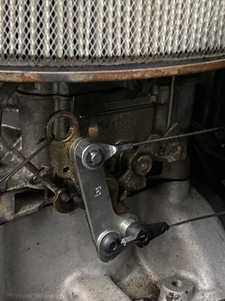

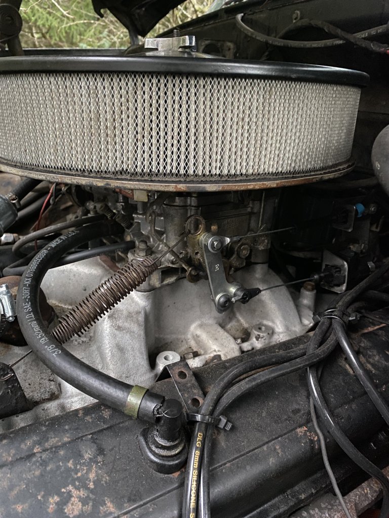

Thanks for your quick reply! I am really not sure if the carb is aftermarket or oem. We bought the truck off my husband's buddy and he didn't have much info on it other than at some point the engine and transmission had maybe been replaced? Here are some photos of the throttle cable bracket, looks like it is an Edelbrock as well.
As for the dash the shift window doesn't show us anything! we have to count when putting the truck into gear because the window doesn't show shifting....

that looks like a tv cable geometry bracket
with the engine running, how tight is that slack in that tv cable(bottom bracket)

the cable appears ot be in teh right spot but im worried looking at it thats its not properly adjusted.

I cant tell what carb it is either but it appears to have the same brackets asd a 1406 edelbrock, but the throttle opening and the idle cam either are somehow active or are grossly not set right.. on .. now which one is it?
here is my linkage with nothing on it
Assuming it is an edelbrock type carb, it just appears to be forward much more than its supposed to. or, rather, rearward,. too vertical. so the geometry may not be right
