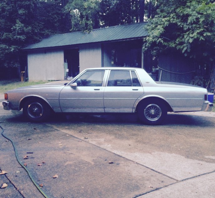

So I figured I'd give an update on the old girl. I worked on it the whole summer and only managed to put a new hood and do brake work on the Jimmy so let's see if I can remember everything. After I got it back and painted, it wasn't running the greatest. After much diagnosis, it turned out to be the ECM, and there's still a little funny business going on there, but it runs pretty great. I also fixed the vacuum leaks, fixed the ignition timing, replaced the EGR, replaced the inner fender, installed a battery tray, flushed the cooling system, replaced the heater core, fixed the horns, did the XJ steering shaft, and replaced the wiper motor (still not all the way right). I had a new windshield put in, and I replaced the wiper blades. I worked on the lighting, and lighting there's plenty of. I got everything going right on the outside, but I'm still coming up short on the inside lights for some reason.

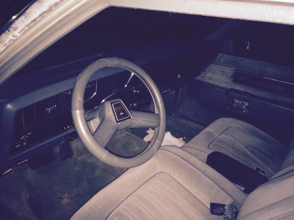

The most involved portion was the interior. I lost my before pictures, but let me just say it was awful. The headliner was slashed, the dash was cracked and embedded with filth, the carpet was worn and ripped and extraordinarily filthy, and the seats were pretty dingy. The carpet was the worst part of it by far. I overhauled the entire thing minus the headliner which the folks that painted it did for me. I took the seats out and steam cleaned them to where they looked years better than they did. While I had that out, I tore out the carpet, which I doubt had been cleaned in fifteen or twenty years if at all. It was so nasty that I just drug it away from the house and lit it on fire. Once everything was out, I saw that the floor metal had a lot of surface rust all over and rot through on the passenger side where the heater core had been leaking for God knows how long. I cleaned the floor up with one of those black stripping wheels for grinders that they sell at Home Depot, painted it, and patched the floor pan. I then began to install and figure out the carpet. It was my first one so it was easily the scariest part of the whole thing because I didn't want to ruin it. I finally got it trimmed up and installed so I put my clean seats back in. I got a molded dash cover and installed it. I didn't glue it or mutilate the old one since this one is a perfect fit and makes it look as good as new. I replaced the crushed up sun visors with a good condition, used set off of eBay. I cleaned up the dash and all the paneling, replaced the lock switches, DS window switches, window motors, rear view mirror glass, horn cap, brake pedal pad, and radio/HVAC controller. It looks so close to a brand new car on the inside, and with a few more small tweaks, it will.

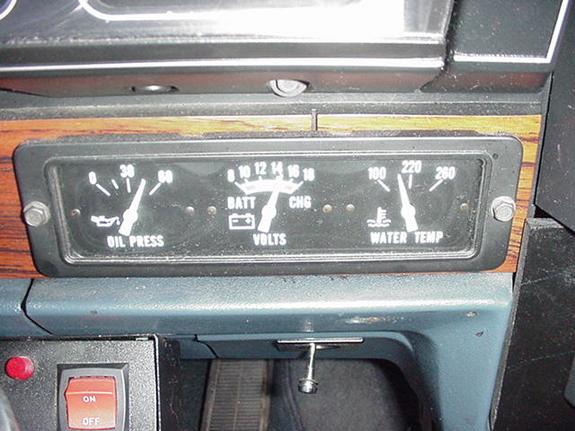

5. I need to do my instruments and lube my cable. All I have are speedo and gas. Not even the dummy lights work because the sender wires were all clipped by a dummy. I have the 9C1 cluster that @RetroC10Sport sent me, and I have the 9C1 auxiliary gauge set. I need to somehow turn the odometer forward on the new cluster and replace the lightbulbs with Silver Star incandescents. I have to install the auxiliary gauges, but I am not sold on cutting the dash. I thought about making a wood box painted with Minwax to resemble the dash that would protrude from the dash, and I could feed the wires through the ex-cigarette lighter hole. Opinions?

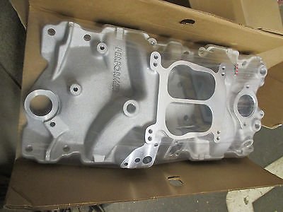

Once the car has been restored to a functional member of car society to my liking, I have a free L69 305 that my brother gave me with 601 heads that'll go in there. My dad had a cylinder head shop rebuild the heads, but I don't know if they ported them to 1.94, and I know he doesn't know. In my dreams, I guess. It has new rings and pistons, and the block was honed out. This is all I know of, but it could be a proto-Vortec motor, and I'm just not aware. It's practically new, and what I have planned for it is an Edelbrock 3701 Performer Intake, a Summit Racing K1102 flat tappet camshaft, a set of headers, a friendlier Y pipe, an AIR delete, and I guess a heated O2 sensor to cope with the loss of back pressure that enables the single wire sensor to function properly. I'm not gonna mess with the heads because even if they haven't been ported, they're brand new, and I don't wanna disrupt that for a few horsepower. I'm not trying to build a racecar, but I'd like a nice, peppy motor in the end. 300 HP is my goal, but if I don't get there, it'll still be noticeably better than it was with a peanut cammed LG4 weenie 305.
