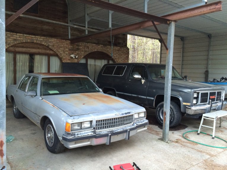

Finally got the Caprice home. I got the title and antique plate purchased Friday, and I got it towed today. I went home, payed for the tow, and immediately met my girlfriend to go fishing. When I got back, I checked and saw that it had fluids that were used but not worn out. I cleaned up the battery bolts with a wire brush, and got the Jimmy battery in it. I turned the key, and the dummy lights did their little test so I turned the key to see what would happen. The last time it ran was last July, and the engine is six years old so I wasn't expecting anything disastrous. The starter sounded a little weird, like skippy or something (probably needs to rebuilt), but after a few tries the engine coughed to life, and with only a few moments coaxing, it idled by itself. It ran pretty well. I'm gonna call Jasper and ask them what engine is in it because I found some kind of serial decal. The engine is bare bone stock. It doesn't appear to have ever had a full tune up or major accessory or component replacement. The O2 sensor was new, and the alternator had been replaced, but everything looked like it had never been touched, which is bad because it should have been, but at least I know what to expect, and I can do a full tune up next weekend and make it run great. I tried the transmission, and the car ran and drove. I didn't go any farther than my driveway, but I think I really lucked out here. As far as the suspension issue goes, I inspected the front suspension components, and everything looked great except the shocks. I did a bounce test, and it might as well not have had shocks because that thing will nose dive to where the front bumper almost touches the pavement. I think that should fix my issue, and if it doesn't, it can't be that serious. Tune up to make it run, fluid replacement, and then I'll do the shocks. It should run and drive superbly then, and it's off to the body shop.
