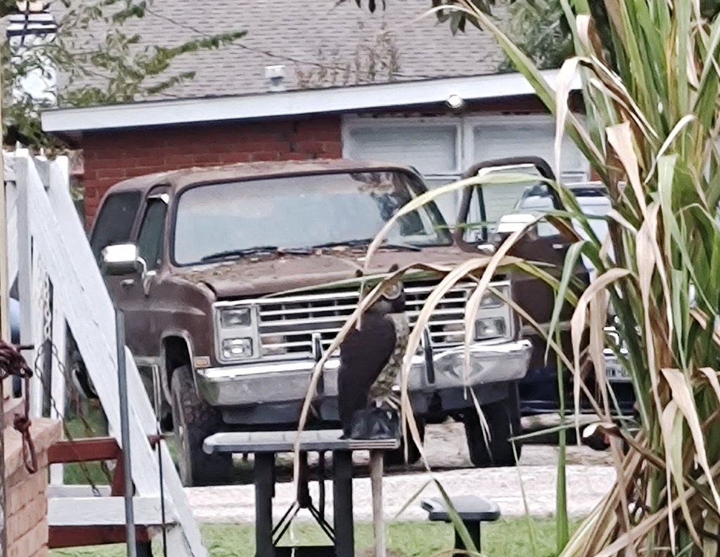

Just curious, I happen to notice that mine has “car style “ mirrors on it, small base.
Then I noticed others have the larger base like this one I posted earlier that on a van but look similar to ones on our trucks. Was there an option, or is there one more correct than the other? Mine doesn’t bother me, just curious. Thanks in advance.

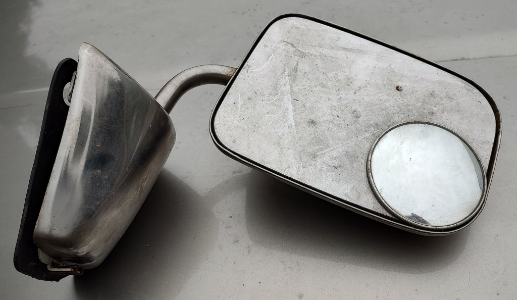

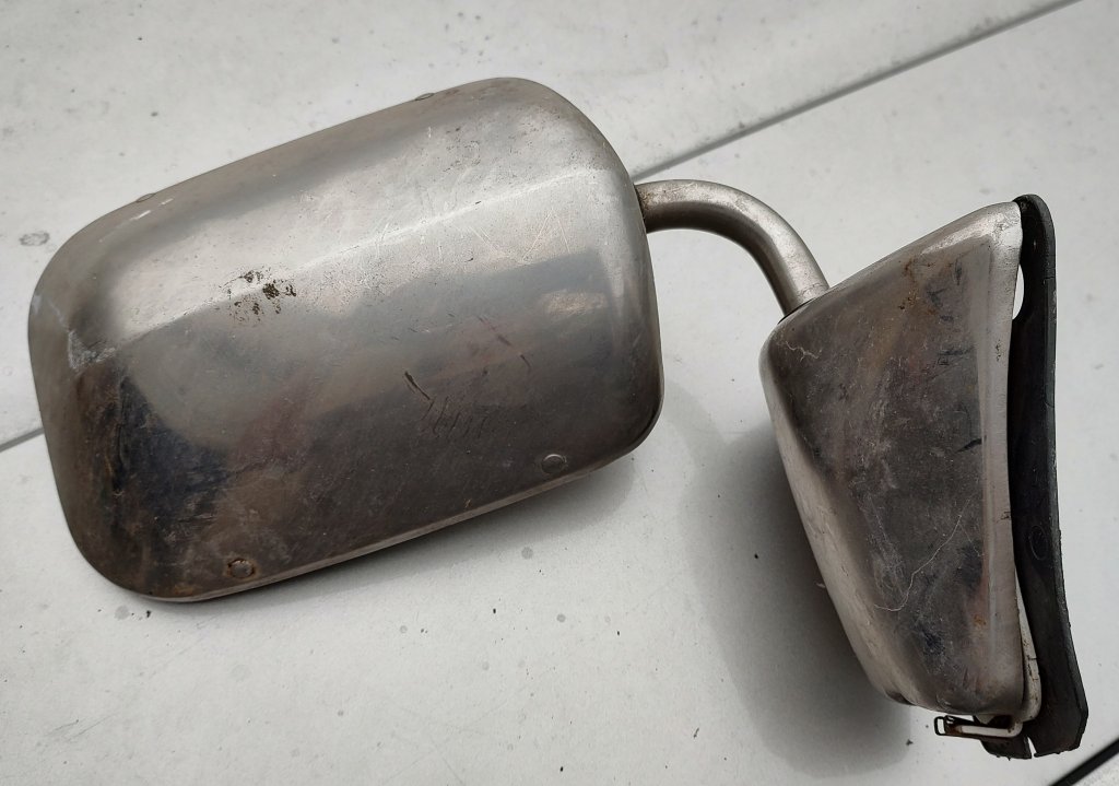

The small (car style) mirrors were the stock standard mirrors. The larger mirrors were an option.
The van mirrors have a crook in the L post that the mirror head mounts on. Pickup/SUV ones, that post is straight 90° angle. You can see the crook in the van picture if you look closely.
Here's a couple pics of the truck style:
