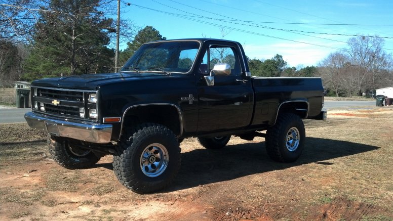

Here is mine. Finally! Pro Comp 4 inch, Mickey Thompson Classic 3's, BFG
KM2s 35x12.50.
