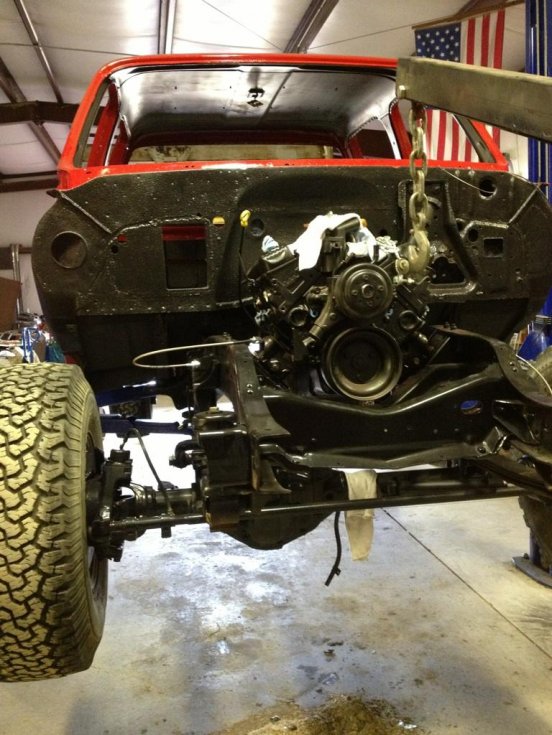

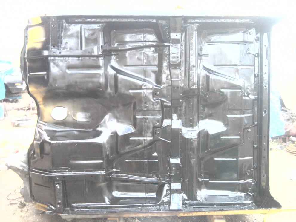

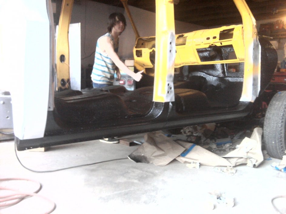

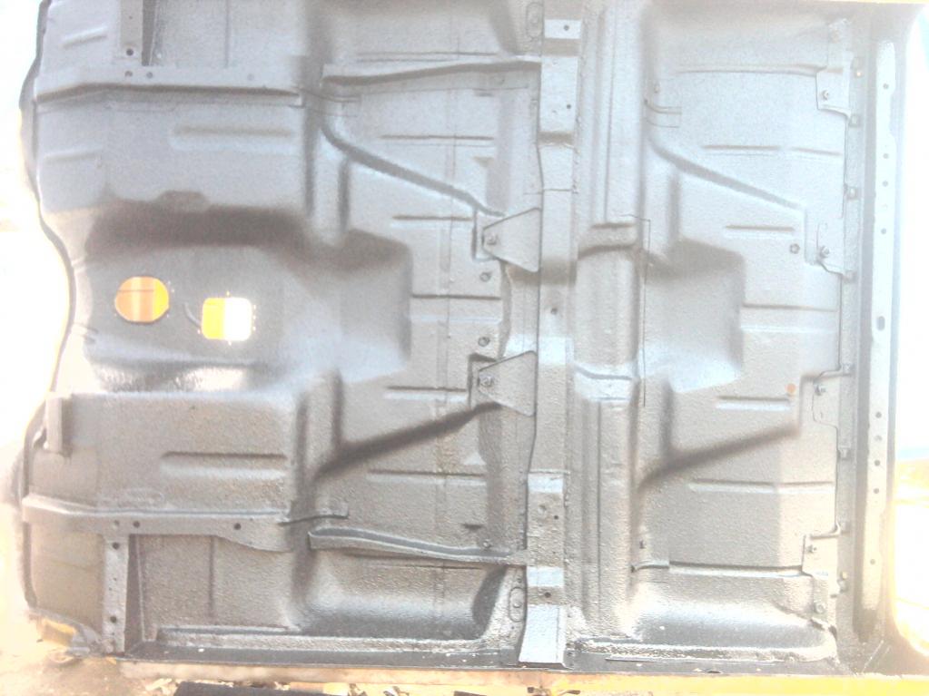

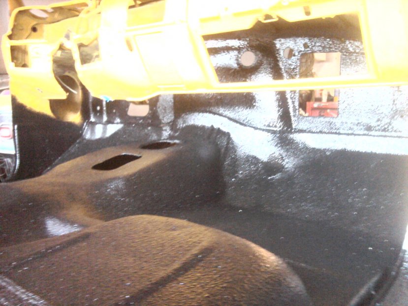

i don't have to worry about rust under my crew cab anymore
por 15 and monstaliner inside and out on the firewall and rockers
a archaeologist is going to dig up the floor of my crew cab a million years from now and wonder what the hell it was
