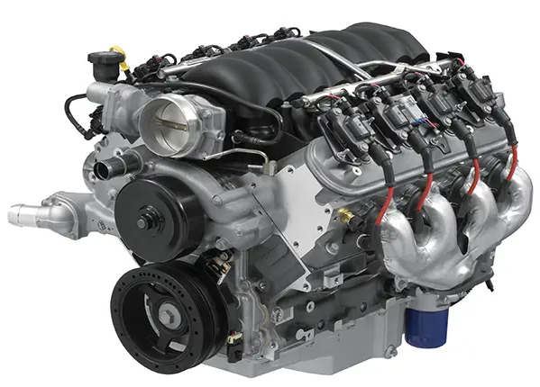

That's an easy one. Just don't ask what kind of oil to put in it.
