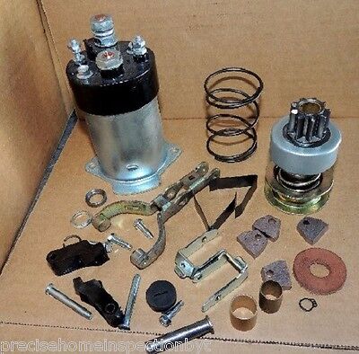

Also, for my stock starter, I just got a rebuild kit from napa and pulled the old one apart. I cleaned it, replaced the brushes and the bushings, and threw it back together. At the same time it is prudent to take apart the solenoid and inspect the round stud portion that rides on the shaft during a start. Those tend to wear out and you can refresh the life of the starter by pulling the bolt out and flipping it over so the other half rides on the round disk. I think I got a kit like this, but it was only like $20 when I got it.
You can also just get a kit on ebay with all the things:

Thanks for this! I was thinking of having someone rebuild it if I can't get the right one from the parts houses. We used to have a shop that rebuilt starters and alternators. Don't know if they are still there.

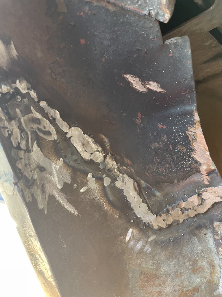

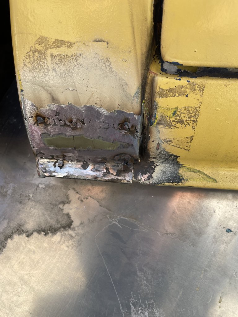

Took care of another patch and the inner support panel this morning. Next, the two drivers side panels. The sun has made its way to shining on me so I am going to do something else.
Hello 82sbshortbed! I hope all is well.
I just wanted to comment that a rebuilding your starter is not a hard or complex operation.
I have done it before and if I can do it I believe you can too. It is just a bench top job. If you have a compressor to blow everything out and remove and replace the brushes.
Remove and replace the parts on the solenoid is the same.
Be well and stay safe out there. Best wishes to you and all of your loved ones always!
