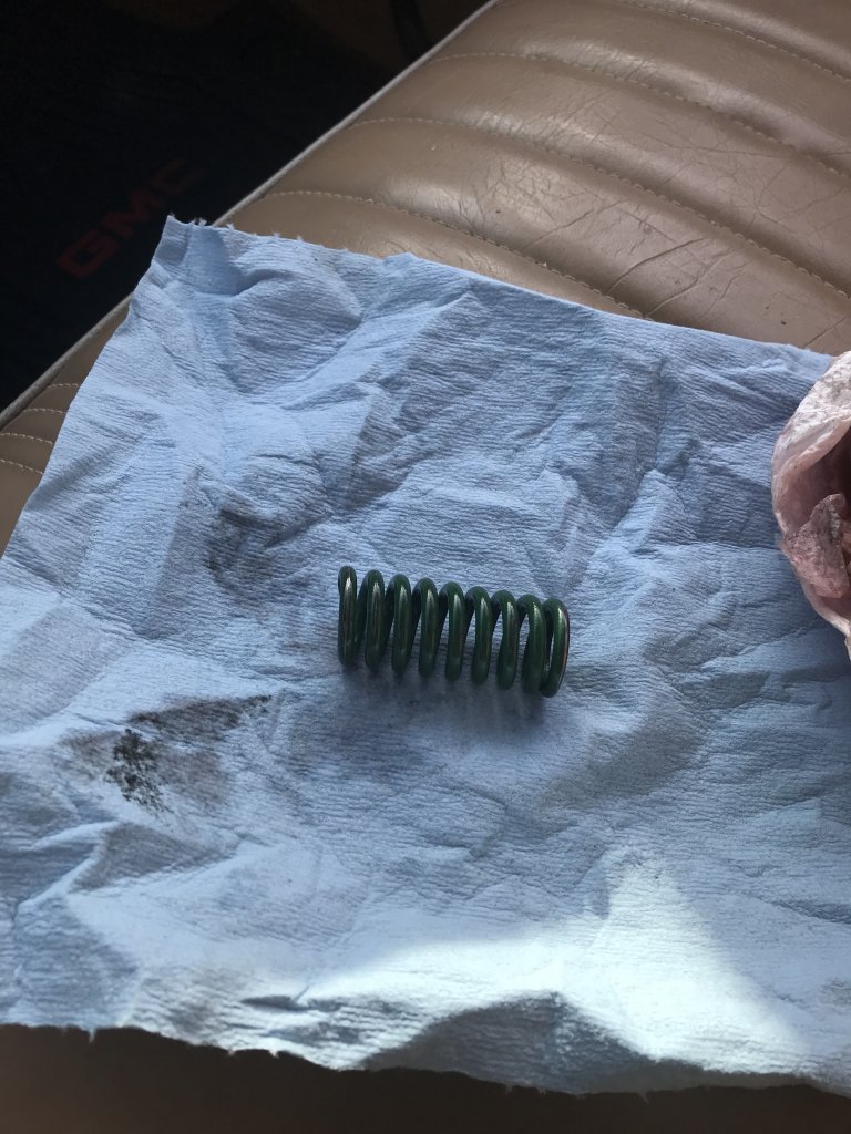

Well Bingo! I took the spring out of my old trans and when I popped the cover off the new one I found a spring that was cut off an inch shorter! Had fun getting that split ring back on though
She shifts real nice now. Nice little bump into second that’s still stronger feeling than stock but not harsh at all.
Also checked old trans and found the clip for the speedo drive gear missing and gear was no we’re near where it should be. I’ll work on that next.
Thanks so much Nick!
Nice job, Keith and you're very welcome!
Now you know the relationship between that spring and piston and shift feel insofar as the 1-2 shift is concerned in the TH350, and to a great extent, same for the 2-3 and similar in pretty much every other GM transmission that uses a similar accumulation strategy for control of shift speed and feel.
No amount of screwing around with the kick down cable or monkeying with the modulator would have fixed that problem hence why I didn't suggest you bother with those two things...I can't tell you how many times I've heard my TH350 customers tell me how their transmission slamming into 2nd gear and they don't know why. But mystery gets solved as soon as I take off the 1-2 accumulator cover...
I'd suspect your 1-2 feed hole in the spacer plate has been opened up as well so you may still have an uncomfortable 1-2 shift even after replacing the accumulator spring so to fully fix it, you may need to replace the plate with another, unaltered spacer plate. Let me know if you have to cross that bridge and I'll help you as best as I can remotely.
