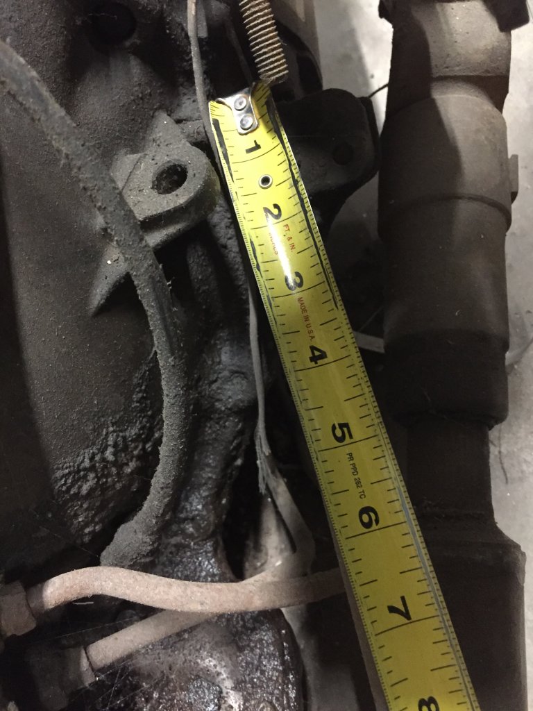

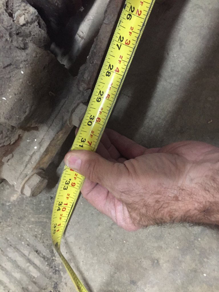

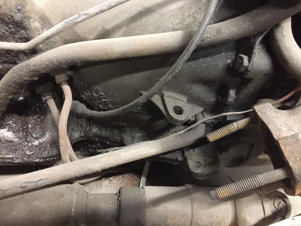

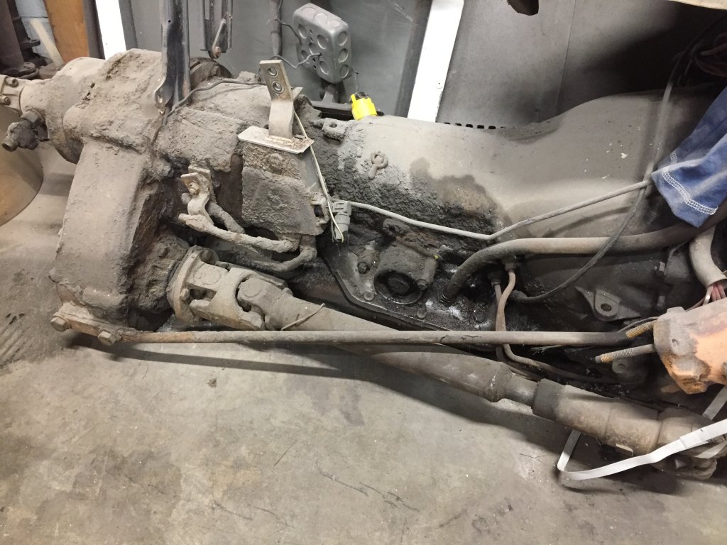

Here’s what I have, not sure what transfer case it is but hopefully you can tell if it will work.

That looks like a TH350 with a np203.
Do you have a pic of the back of the transfer case? I would be able to tell for sure. Thanks

That’s definitely a 203 tcase.
The rods for a th400 vs th350 are different.

Actually just looking at both rods. They both measure about 30" to the first hole.
Maybe they are the same?
The 400 is longer, about 3”. There is a difference in length between a 203 and 205 so I’m not sure if that would coincidentally make the rod similar lengths.
