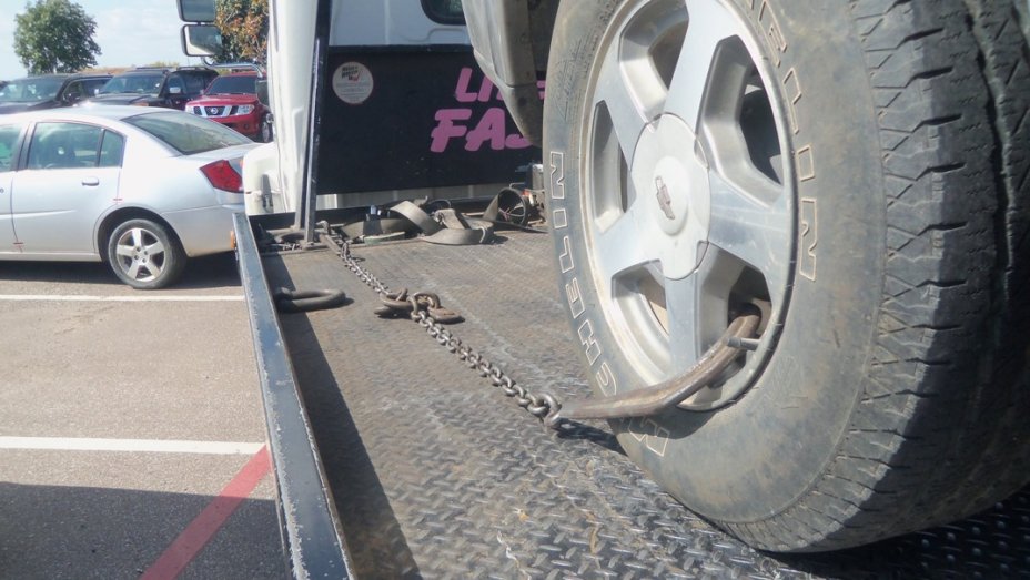

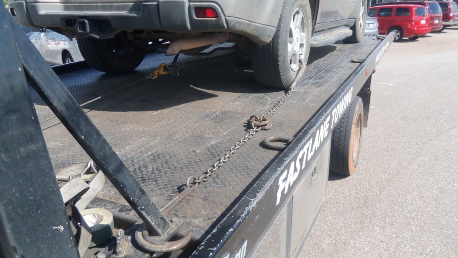

Yep, don't be afraid to ask all those "dumb" questions. If bossman acts frustrated with some of the questions, just tell him, now that you're in the biz and have talked to others, you've heard horror stories of damaged vehicles over very minor overlooks or unknowns. For example, I didn't even know Juke came in an AWD model. If it was not for that damn Pure Drive badge on the back of the car as I walked around it doing a safety check, I'd have never known and would trashed a power train. And many guys don't even do a safety walk around either. Sure, it takes and additional 30-45 seconds to do and 95.5 % of the time you're not going to find a thing wrong, but it's 4.5% of the time that you might find or notice something that can same more damage, an expensive powertrain mistake and at worst, maybe even save a life. Something come flying off the back of a car you're not familiar with but towing, and someone hit it or swerve to avoid and cause a major accident and someone gets hurt badly or killed. It's bad enough working a fatal knowing someone lost their life right there where you're at, but I can't imagine working a fatal that was for my own irresponsibility. So do ask the questions. Get in the habit of doing a walk around on your towed vehicle, and even your on deck vehicle for that matter. You're looking for things that can fall off the vehicle, like a taillight or turnsignal that's hanging by a wire. Take it off and throw it in the car, bumpers or covers that might be draggin the ground and can eventually fall off, strap them on, bunjie cord, or zip tie them on securely, looking for exhaust or driveshafts that might be hanging low and can grab a pot hole or high surface in the road. Also look at the tires that are on the ground, are they rubbing on something or have a cut in them that may cause a failure, and for christs sake make sure you have lug nuts and wheel studs. I have done this safety check before and found a wheel had 3 broke studs and only 1 lug nut holding the wheel on. Luckily the other one was 2 away from the 1 good one, and I robbed a lug not off the untowed wheels, and then took it real easy knowing I only 2 of 5 lug nuts. Sometimes it's PROBABLY safe to go, but you can do something like take surface streets instead of the interstate. Might take another 10 minutes but so what. Going 40 is better than 65 with only 2 lug nuts. I cheat where I can, like only using 1 safety wheel strap on the driver side to the L arm. Only 1 safety chain from the bed to the front of the towed vehicle. Now if it's a heavy vehicle, I won't cheat. I'll do straps on both wheels and both safety chains. Reason being, what happens if your wheel lift breaks and you drop an L arm and it's the one you have strapped? Sure the damage is going to be bad, but at least it's going to be damage to ONLY the towed vehicle and not another motorist.
I always use at least 1 safety measure on deck too. If your winch line breaks or your winch breaks and free spools, you rear chain(s) will loosed of course, probably have your Mini J drop out of it, and now you have a car on deck rolling off the back of your truck into traffic. This isn't pretty and chances are it might damage the wheel, or stabilizer bad, but whatever you can get a safety chain to catch a roll off from happening, you'll be able to live with a bent stabilizer or scratched wheel vs dropping the vehicle off your truck and totalling it and whatever else it hits.
This is my J Hook bridle. I rarely use it, but I like to have it for major damage vehicles or big full grown 3500HD or F450's and such. I use my cluster hook bridle 95% of the time. Stuff like the river truck, I used the Big J hook bridle cuz there was no getting to the hook points. But here you see what else I use the J hook bridle for. Not pretty, but effective if the winch free spooled or winch line broke. It's not tight at all, but it's only going to roll about 4-6 inches and stop, and you can bet I'll feel the jerk and SLOWWWWLY come to a stop and get pulled over. It has paid off 1 time in the past since I don't put the vehicles in P or set the E brake unless I drove them up on deck, and can drive them off deck. Otherwise I won't don't want to be a monkey jumping up on the bed to re release everything, or get out a tool to bypass the shift interlock on one that doesn't have any power at all. I'd rather just safety chain it than get up and down on deck 2x and hurt my back more than it is already.

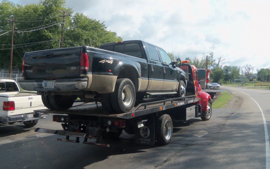

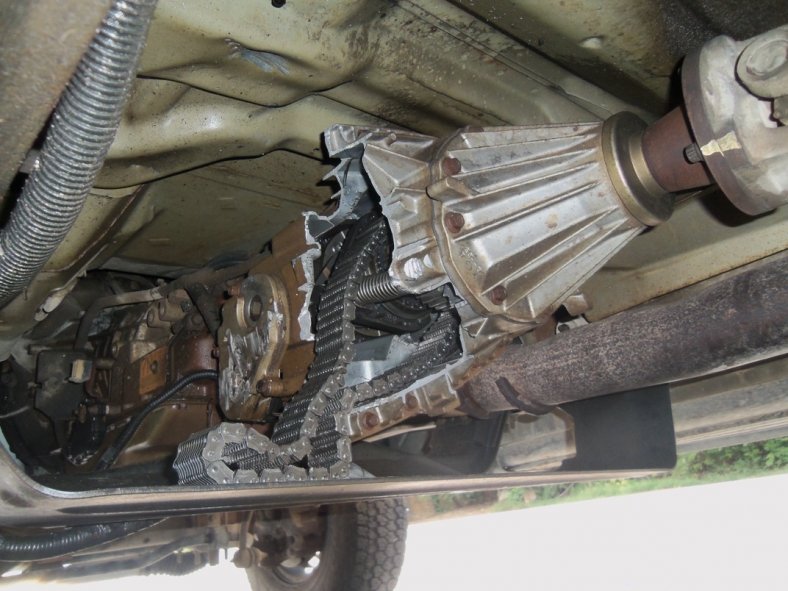

Seems HR pulled in a Ferd with the exact same trouble at his last job.

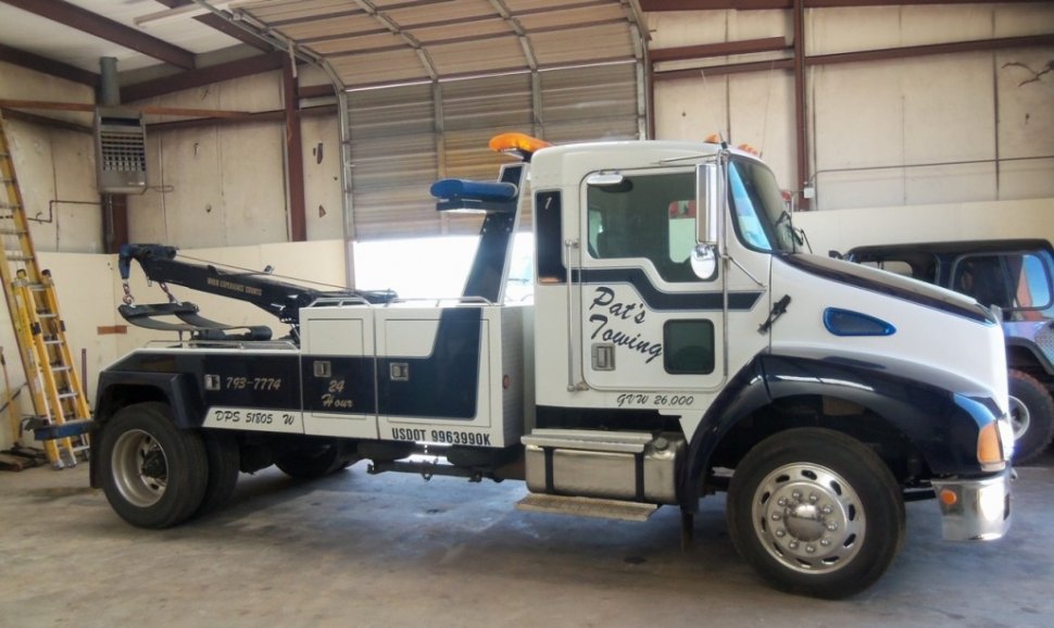

Nice Medium Duty Rig !!! Great for Motorhomes and busses, etc. This is the only Medium Duty Conventional I've operated. This was the last company I worked for.

:rofl:, I sure as hell did. Catastrophic Failure. 2nd to the last run I did in the Peterbuilt for that company. Picked it up in Ft. Smith, AR
