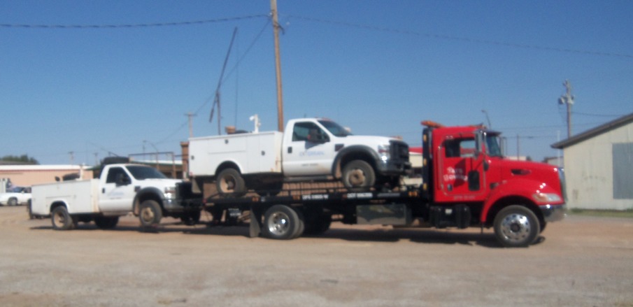

So when are you going to start posting up your tow rigs, equipment and some carnage. You can start a thread in the Members Photos section if you want, or just add it to this thread. What truck are you running anyway?
I'm currently running a Hino X Cab of all things with a Vulcan 21 foot bed. Power Locks, Windows, Tilt Cruise, AC, Air Brakes, Air Seat, Rear Air Ride with Bag Dump which comes in handy on the low to the ground vehicles, or if I ever get stuck in mud like did out at the river, and had to use my wheel lift to lift the truck and push it forward out of the hole when it sank the rear wheels to the hub on 1 side. It was catty wompus, I couldn't even send the bed home. One side above the bed lock, the other side went over the top of the bed lock. So first I leveled off the truck to get the locked in home which helps make the whole truck more rigid, then used the wheel lift to get another bite, then lift and push the truck forward. I didn't tell you that trick either. And I wouldn't let the bossman see you do it. I only do it when I don't have a choice. You can also use your bed winch to pull yourself backwards. You can even pull yourself forward if you have enough cable and snatchblocks. I've turned my Perterbuilt with a Jerr Dann bed, 90 degrees before using the winch and snatchlocks hooked to trees out in a rural area recovering tornado damaged trucks wrapped around trees.

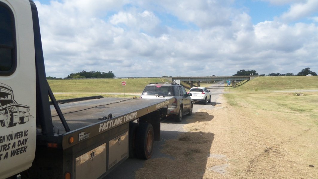

So I had to hook the Juke rear wheels up and drag it off in Neutral then flip it around it get the front wheels off the ground to not burn up the trans. I took it about a mile @ 30mph to find a big enough lot to drop it, drive around in front of it, and rehook it.
attachment.php
So I get in front and get it hooked up and ready to haul balls back to the city, dropping off the Juke FIRST at Norman, OK on the way into OKC. (Didn't get a pic of that, I was pissed and forgot). As I'm walking around the Juke across the back to make sure nothing is dragging or I don't have it lifted to high and would be dragging it's ass on pavement, I happen to notice this badge on the back of the Juke that says, Pure Drive. As I keep checking all my safety chains, and straps, then into the cab of the truck to take off and get on the Freeway, I'm thinking, WTF is Pure Drive??? :shrug: Then it hit me, I better check that thing out. Sure the hell enough, I look under it the rear end and it's got an IFS axle. I look up front too thinking maybe it's RWD and not FWD afterall. Nope, my luck...Pure Drive is All Wheel Drive just like I fuggin figured. So I am very very glad I thought to wonder WHT is Pure Drive or I'd have made a few thousand dollar mistake and cooked a trans and probably a Tcase. But now I have alot more work to do, cuz the Juke has to go on deck. Now I had to unload both vehicles.

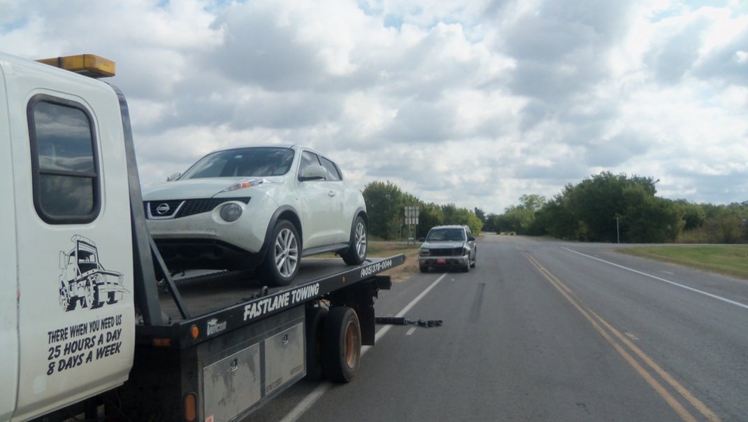

Flip a bitch in this big ass truck, and then load the Juke.
attachment.php
Then Flip it again to get rear wheels up on the Copart since it's RWD, and prepared to tow backwards.

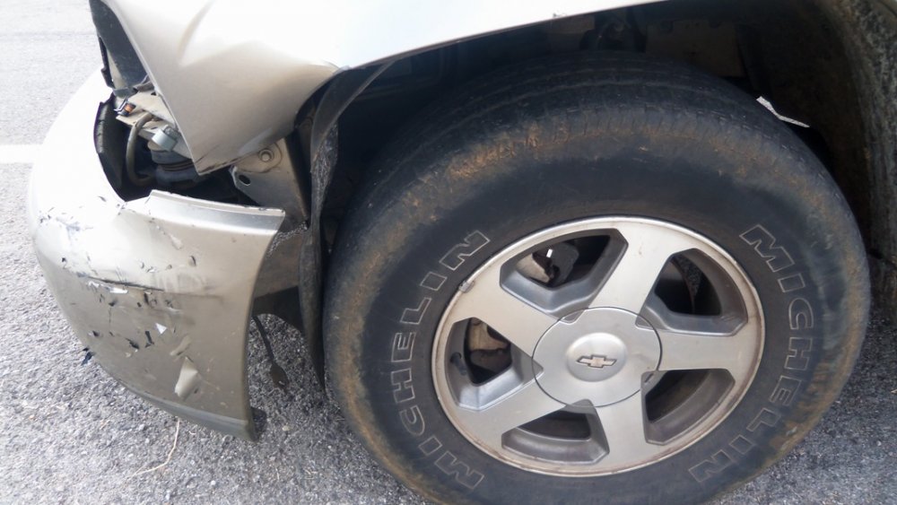

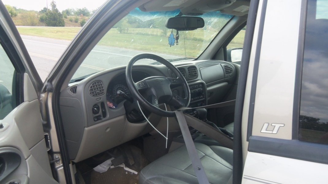

And wonder how well this is going to tow with the fender well pushing on the tire. It's just plastic, I'm going for it. Fugg it :flipthebird: I did use a pry bar and got the about an 1/8 inch of clearance. It'll hit on the bumps every now and then but it'll tow fine.... I hope.

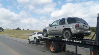

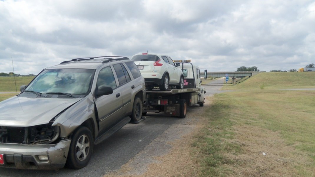

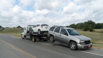

So then I get the Copart Trailblazer hooked up on the stinger and strapped down. Now ready for bidness and hit the interstate. FINALLY.
attachment.php
attachment.php

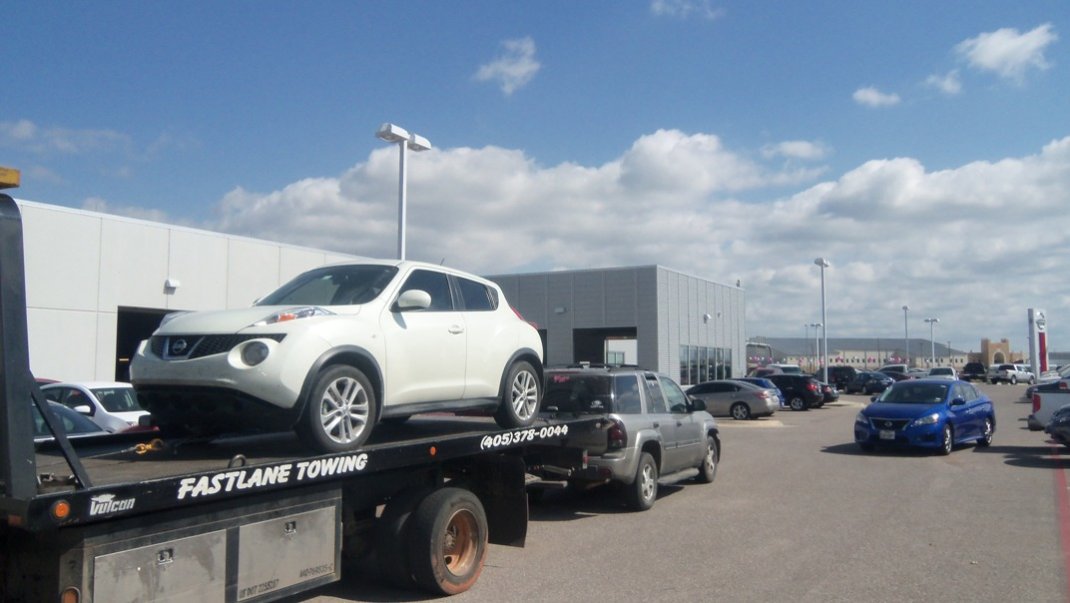

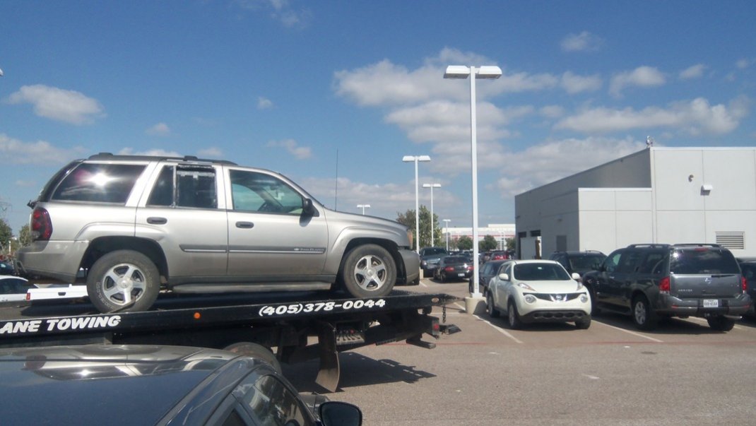

Then get to the dealership in Norman, OK and have to drop the Copart Trailblazer to get the Juke off.
attachment.php
Then of course, push the No Start, No Power Juke into a stall by hand cuz there is no damn room in this dealership, not even in Tow Row to back up a roll back, even a short one let alone a long one with a 21ft bed and X cab. Got'r Done while all the Service writers watched with their fuggin hands in their pockets playing pocket pool. And of course load the Copart Trailblazer on deck.
