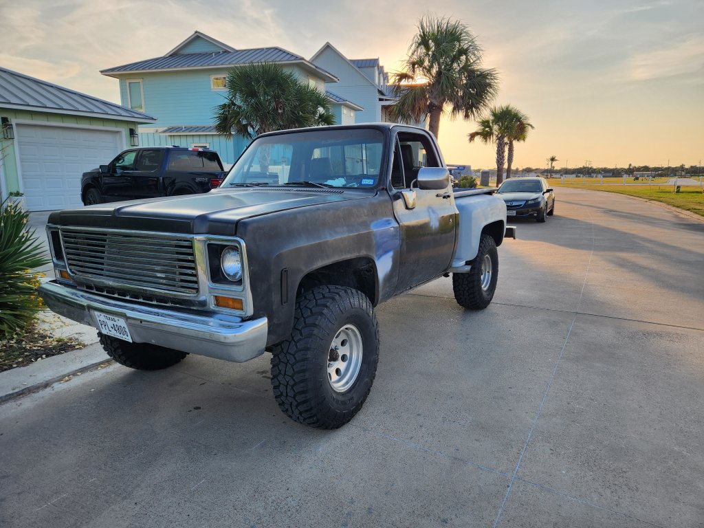

I thought the same thing, then looking at his post harder I think he's looking for a recommendation for a bigger bar. Stacking 2 factory bars comes to mindSpindle lift? Why won't a factory front bar setup work?
Looks cool!im also thinking about getting ne rear leaf springs? instead of the blocks. hope that can reduce roll by adding more stiffness, though i have no clue ho to measure hat i need.
the front is all new. Def need sway bar.Looks cool!
Springs are measured by length. And just order what you want for spring rate.
I bet your front is what’s causing the body roll. There’s a million lifted half tons on stock springs and that’s never an issue.
Went right over your head….unless you removed rear leafs and it now has an abnormally low spring rate, the front end is causing the body roll. Springs shocks sway bar whatever it may be or a combination of things.the front is all new. Def need sway bar.
I’m not sure @randomTruckKid is actually reading all the posts ….Spindle lift? Why won't a factory front bar setup work?
Well thank yaBy the way you are the effing MAN for lifting your C10 and NOT slamming it !!! My nomination for truck of the month !!!
Rear has several removed leafs. I do agree front is maybe contributing a little. It has new springs but they are factory c10 rate. But I think it's a combination of lack of sway bar and really light rear springs... maybe a little front.Went right over your head….unless you removed rear leafs and it now has an abnormally low spring rate, the front end is causing the body roll. Springs shocks sway bar whatever it may be or a combination of things.
Don't put yourself down. You've done way better on this project than I ever would have anticipated.Rear has several removed leafs. I do agree front is maybe contributing a little. It has new springs but they are factory c10 rate. But I think it's a combination of lack of sway bar and really light rear springs... maybe a little front.
