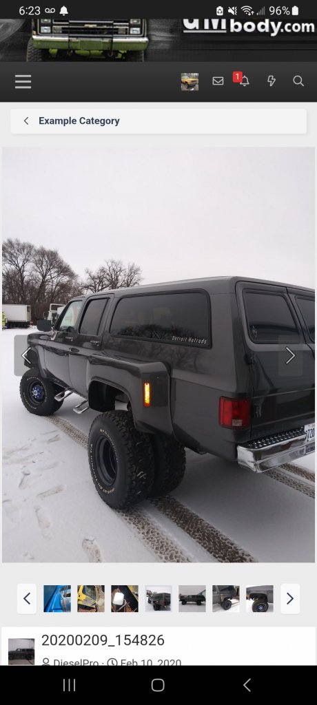

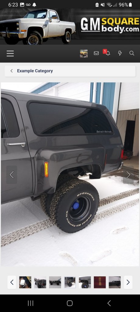

Heres some motivation, Me like
Boy do I like that. WOW. I better now show my wife. She will want one. She still wants to buy a Kodiak and make it just like Ironhide from the Transformers movie. She loves lifted rigs.
