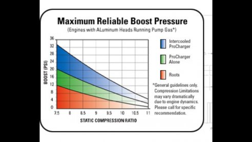

Whats this where back in business
Now lets stager it down to 3 psi

Im not building a drag car look at there power gains its a work truck its a low boost system to increase hp and fuel economy
only in a diesel does that happen.
When forcing more air into an engine, means you have to match it with more Gas, or else your going to lean it out and fry your pistons.
The only addition to forced induction is HP. But lets be honest. NA is where how good of an engine builder you are comes into play, anyone can bolt on a power adder.
