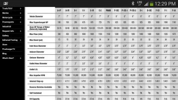

Ok so here do your own math and quit with the it wont work bs
89_3&3
Feb 18, 2014
226
11
vancouver
john
89
3500
So wait a minute there making a 250hp increase a 60,000 rpm empeler speed and i keep being told that 3:1 at 13500 rpm wont build enough pressure to make any boost hmm thanks for your expert opinion but I think ill continue anyway

You are leaving out one VERY important detail. They have an inside multiplier, in ADDITION to the outside ratio.
So, they are running a 5:1 or so inside the unit, multiplied by the maybe 2 or 3:1 driven pulley, which is still a lot more than just a STRAIGHT 2.5:1 drive (for examples sake).
6000rpm * 2.5 = 18,000RPM
(6000rpm *2.5) * 5 = 75,000RPM
So you're running about 1/4th to 1/5th the impeller speed...and that's at redline.
And yes, impellers are inherently very inefficient at low speeds, which is why you won't make boost with exhaust driven turbo when it's not under load. The load drives the impeller speeds up and THEN you make boost. You might be lucky to make 1psi with the setup you are planning, which likely will barely equal out with the power consumed to drive the turbo.
But whatever, have fun with your idea, I'm tired of trying to present the issues that will need addressing the make this work. You clearly know better than the rest of us, oh holy one...

From what my calculator says 2.7 pounds of boost minimum at my max rpm thats lots
And look at some dives most look 1:1 and the gear box a the highest 7:1 from some of the ones I've looked at so 3:1 at the least wont suit my needs ?
the specs on the turbo said
150,000 rpm = 30 psi
At 100,000 rpm = 20 psi
So do the math at 13500 rpm thats 2.7 psi at 3:1 and ill try to squeeze a little more than 3:1
The equation isn't a linear relationship. Just because 100,000rpm = 20 psi, doesn't mean you'll have 2.7psi at 13,500. It's also not a question of PSI, but of CFM. PSI means nothing, that's just a resistance to flow. CFM is how much actual air you are moving.
