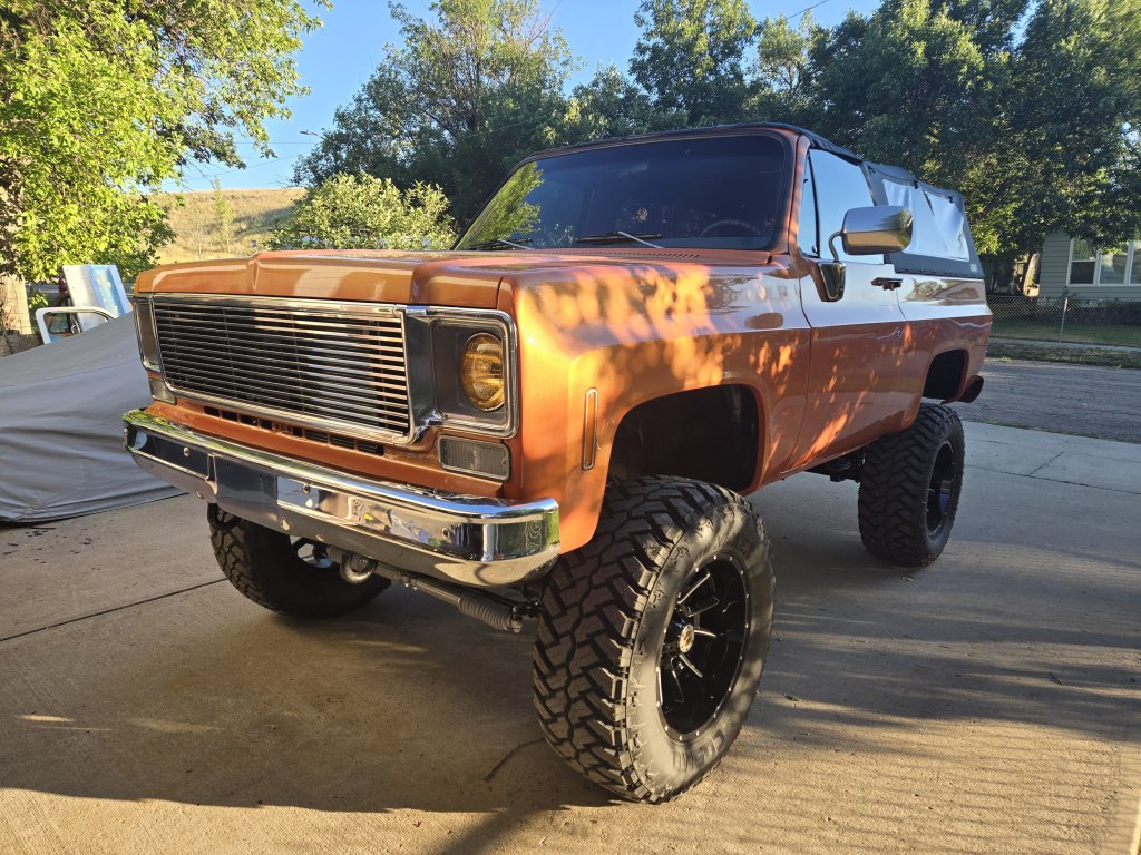

Thanks for all the information. I knew that K5s changed frames in 78 as I've worked on several of them in the past. I've just never done any extensive work on a suburban. Here's a picture of the last Blazer I have almost done.
