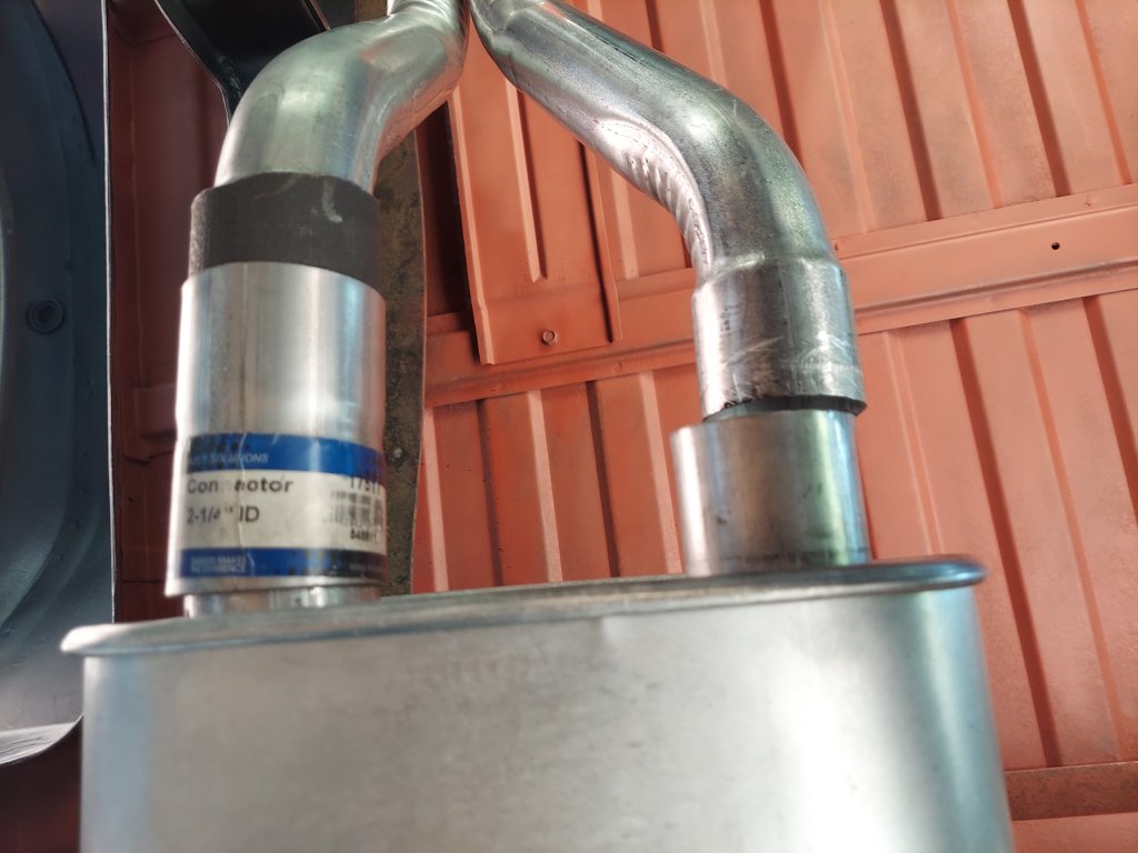

Don't mind my mockup for the exhaust trying to figure out fitting etc. I used what is says on the can on a white background "primer" for the underbelly of my cab. I noticed it was burgundy from the bath coming out of the factory so I decided to go with a close matching colour. Or you looking for chassis suggestions only?
