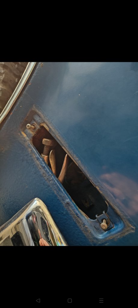

I'm planning to lift the chassis off the frame on my 84 Suburban C20. I want to sandblast and paint the frame.
Is it possible to do that with the fenders attached or do they have to come off? The two bolt upfront behind the lights just spin, the welded nut broke lose. I tried to get a wrench in there, but it's to rusted to brake free.

I was able to turn the bolt by getting a pair of wise grips on it, through the side marker opening and the hole under the battery tray. Not fun.
