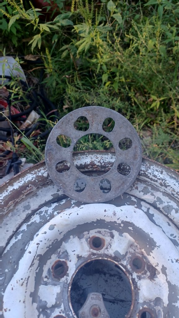

6,299
10,707
I blew your pic up and looked harder,now I understand. I thought I was looking at the front side of a factory wheel,that wheels just made different than anything I've noticed. I think a thin spacer is probably the fastest easiest fix. I thought I was seeing the three raised bumps that hold the hubcap.
