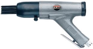

They make a tool called a needle scaler. Basically like an air chisel but instead of a chisel bit it has like 2 dozen loosely arranged metal needles. We used to have them here at work for cleaning concrete off steel forms and machines. I bet this would be a great tool for cleaning a frame off. I have one at home, I need to dig that sucker out and bring it back to life and attack the Burb with it, they really are a great tool. :waytogo:

I'm going to take some video and before and afer pics of that bitch in action over the winter Old77. :waytogo:
:popcorn: I am interested in seeing what the needle scaler will do also. Hurry your ass up 89s
