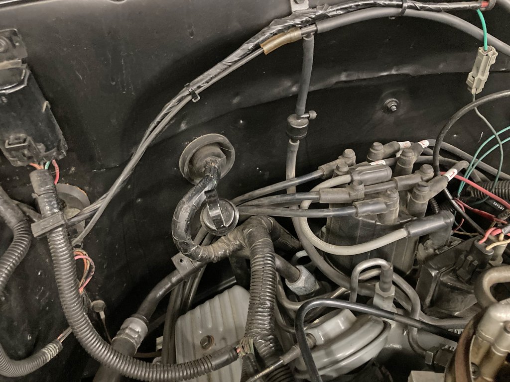

Are you hooked up to manifold vacuum or ported vacuum? Ported won't operate the diverter door at idle.
I think it's manifold? (See photo attached. The line from the firewall eventually ends up at that vacuum port tree in the manifold.)
And now that you mention vacuum to this system, this is an area where I had to "guess" when I (sort of) restored the engine bay a couple years ago. So maybe I've messed something up with the vacuum line routing?
The plastic "hardline" hose coming out of the firewall was damaged a bit, so I had to cut a few inches off. But I'm pretty sure it went into that clear connector. Which went into that "T", which went down into a two-way vacuum tee fitting that I believe was capped on one side. But a lot of this was a guess based on the heavily-deteriorated original lines that were there. So by all means, if you see where I've gotten something backwards or flat out wrong, please LMK.

What I can see looks good, but I can't see where the end of the vacuum hose hooks up.
Plus I'm not too familiar with fuel injection.
As others have stated, if the fan isn't blowing, I'd start looking for the problem there.
Are you missing the vac line that goes to the vacuum reservoir off of that T just downstream of the check valve. I dont recall my setup having a plugged T there. Or does the other line off the other T head that direction to the reservoir? Vac should be good at idle, though.....so I'd expect that to cause more issues in low vac driving situations.

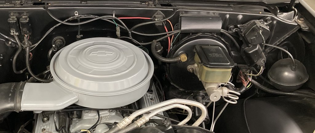

Yep. I got a new, clean hose from the "T" at the clear connector over to the vacuum ball on the driver's side.
