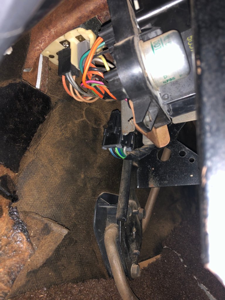

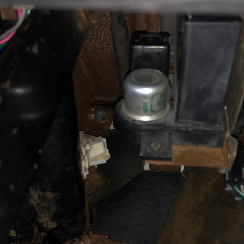

85- look to the right of the brake pedal. It's in the "convenience center"

It's between the brake pedal and gas pedal up high. Sort of difficult to get a picture of it.
Ya know, I remember seeing that one and wondering what it was for. I've already replaced the turn signal flasher. Guess I'll try this one next, thanks!

Thank you Jgonick. This second one was the problem. I have done all my own work on this truck, and I've never noticed that flasher down, lol. Thanks again
