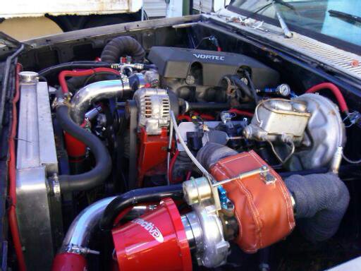

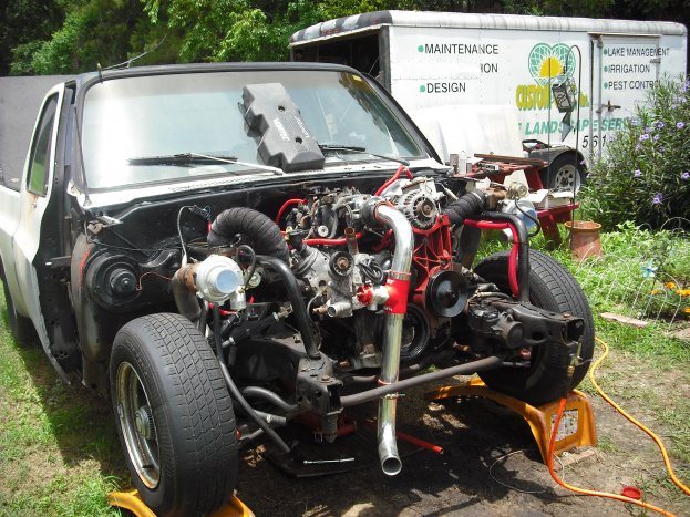

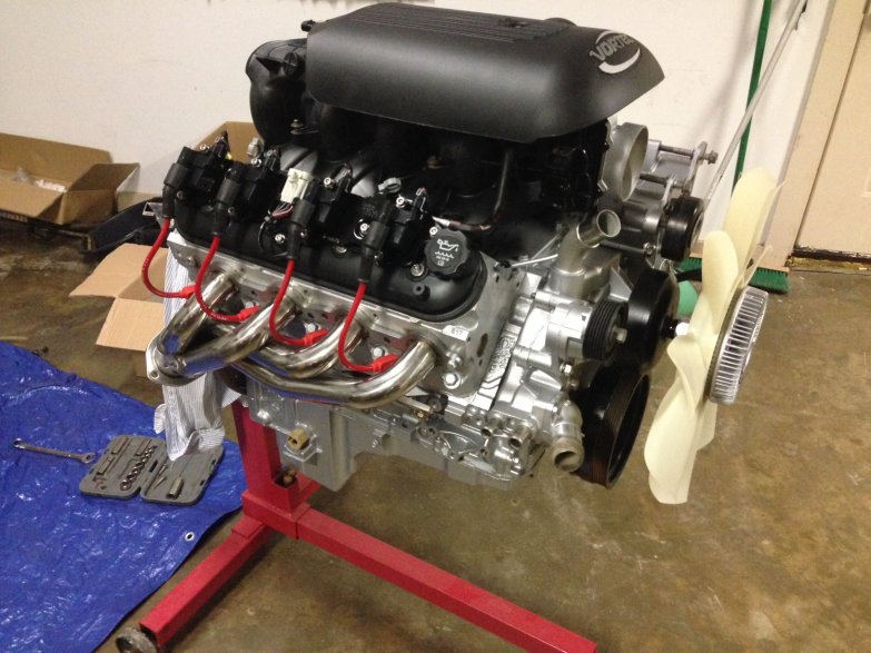

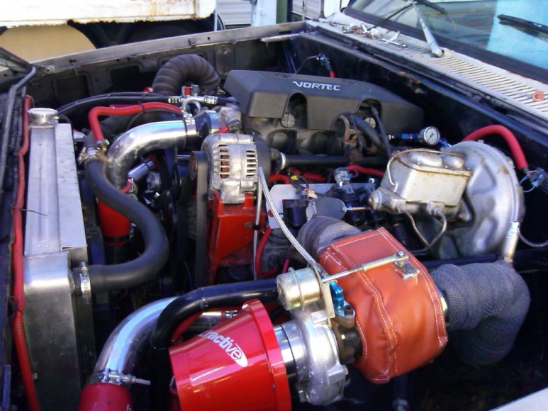

here is my lil 5.3 in a 74

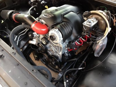

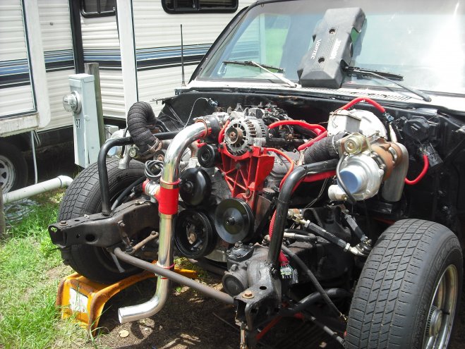

Hey brother can you share your a/c setup with me? I am debating what bracket to get. I have an older lq4 (iron heads) and access to the compressor in your picture as well as the ls version.

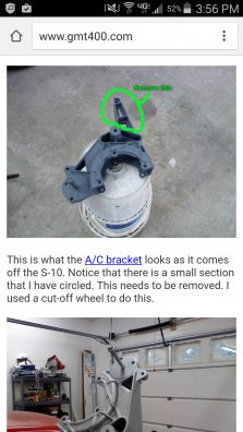

It's a bracket off pre vortec s10. Let me dig ip some pics an I'll post. I got all my info off the Web an reading. My original ac was on driver side. I just moved it. Used same hoses for now an just changed pulleys.
Not my pic. But what I used
My pic

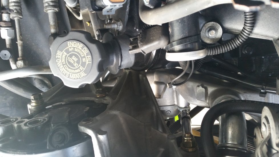

A lil adjustable mount u made
which year S10 was it from?
and the belt line up fine?
looks good and cheaper, but one needs a R4 compressor right?

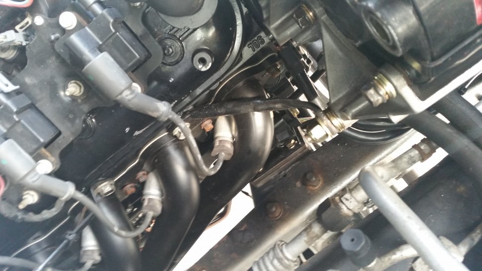

I did have to Mae a lil3/16 space to go behind the bracket where it mounts to the head. You can see it be the 706 marking on the head. I did it with out it first . It depends on the pulley an how far it's pressed on. (Yes it only goes so far but if it's not on all the way it mite be a good or bad )
Hope that helps

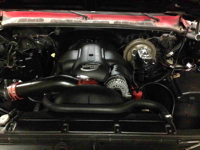

Started from scratch, and progress has been slow as hell. Its starting to come together now tho. Its not hooked up yet, but its only a few parts away now.
