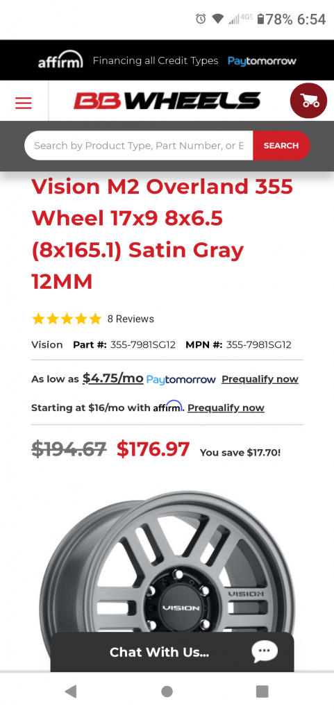

I'm seriously considering Vison Manx wheels. I'm coming up needing new tires soon and I really want 17 inch wheels. I like the look, fit and price of these 8 lug wheels.
