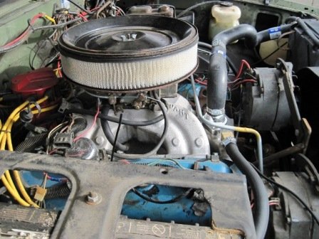

Great truck to work with.
First though know the truck's model is a D30, not a K.
Second, beware of all the 24V that is included in the fuseblock when wiring things up.
I ran 255/85-16 BFG Muds on mine on stock wheels and no lift.
Never any tire interference.

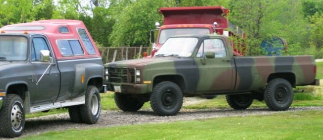

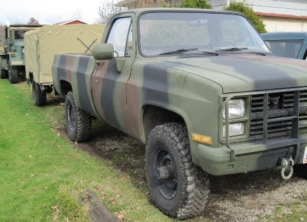

The D30 designation shows up in the serial number because it was built for the military. They're not entirely exact to the civilian model.
I have done a gasser installation of one of these but, kept much of the 24V system so that it would be still compatible with my other ex-military equipment. I did a tall deck but, would do a regular deck BB if doing that one again. Could have saved on the aftermarket intake.
Make sure you have the correct power steering pump/lower bracket for the hyroboost brakes.
