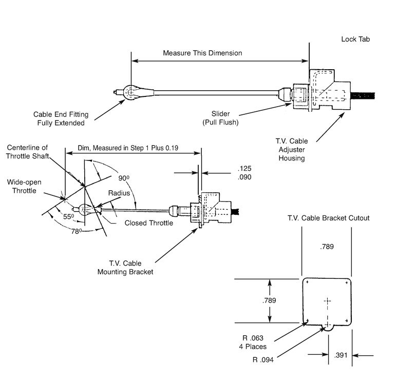

could it be the plate that pulls the cable at the throttle body? im not sure if they chaged depending on the year of tranny/engine. it should have geometry like this:
47,200
9,465
He's going to be checking that when he pulls the pan. That is what Jim is referring to as the bellcrank. He's going to see if it's bent, or the cable itself or the cable housing is stretched.

No, thats the throttle crank, I am talking about the crank that the little hook pulls on down in the Trans.
Like dis:
47,200
9,465
I know what you're talking about. He's showing a pic of and talking of something else I do believe.

I know that I was talking about something different. I would think that if one of those parts were bent that the tv cable Adjustment would compensate for it.
