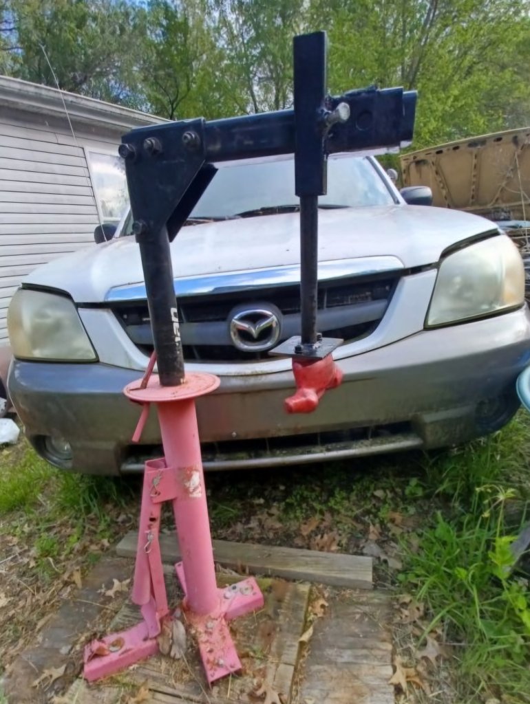

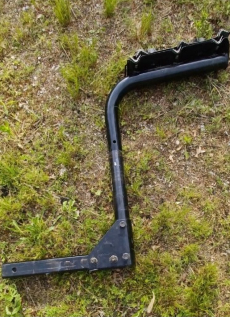

Bike carrier,turned into duckhead Tire mount. Works awesome!
I had one of those bike carriers what a pos! My 80 year old neighbor now uses it to drag his trash cans out to the pickup spot with his side by side!

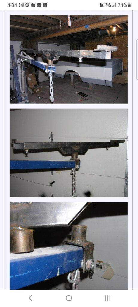

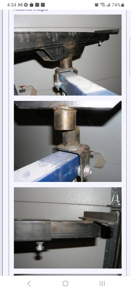

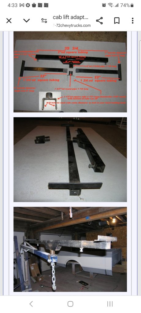

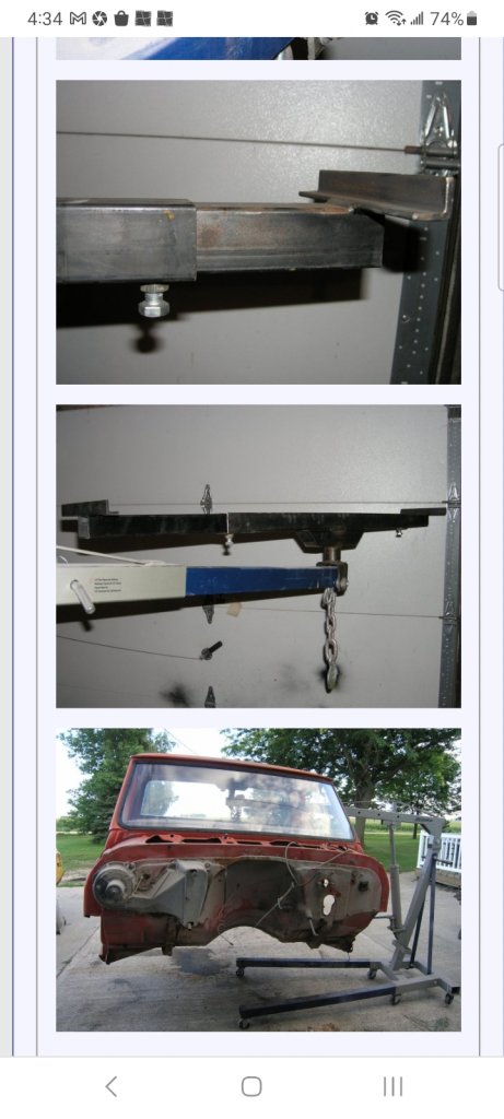

Cab lifting beam for use with cherry picker
