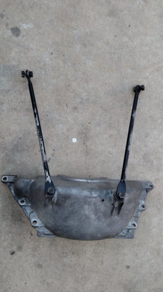

As for your flexplate cover,a 4x4 cover is cast and has bosses for braces to attach to. Your missing the braces also. At this point a 2wd cover is better than nothing,until you find braces and a 4wd cover. I actually ran with no cover in the past,I ran over a basketball I didn't see and wound it up in the flex plate,yes,something is better than nothing

Describe said braces :) they go on the outside of the cover and attach to what?

Dead link here's a pic I stole from @SquareRoot
Thank you
Yes that’s it. What are the braces bracing? Like keeping the cover in place? Or supporting the weight of the tranny?
Looks like they bolt to the frame or crossmember? I would think the 6 bolts would hold the cover on?

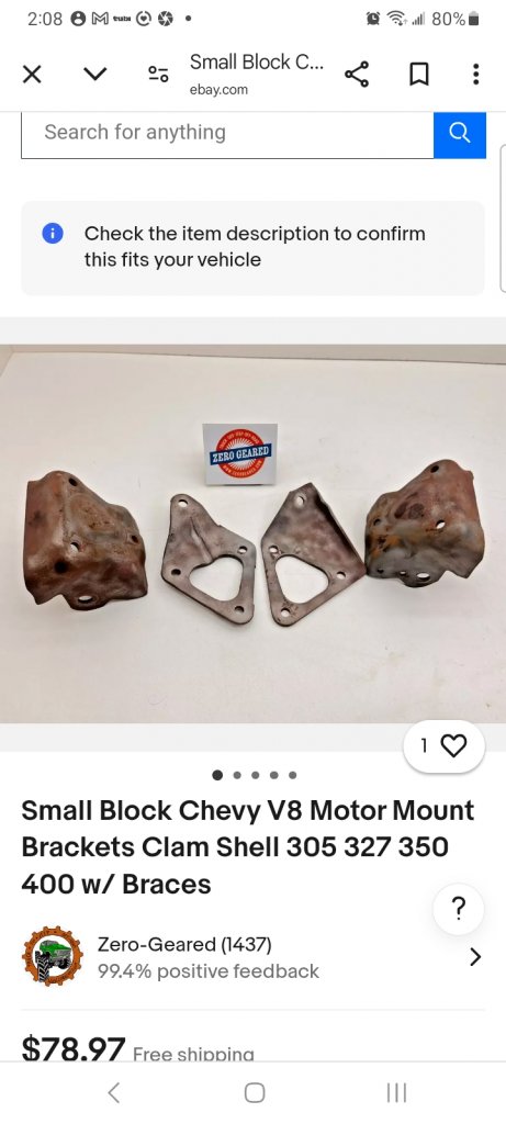

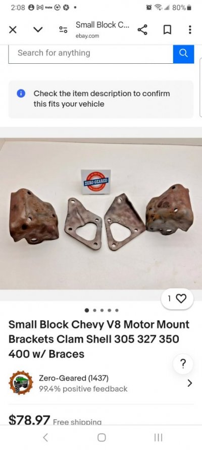

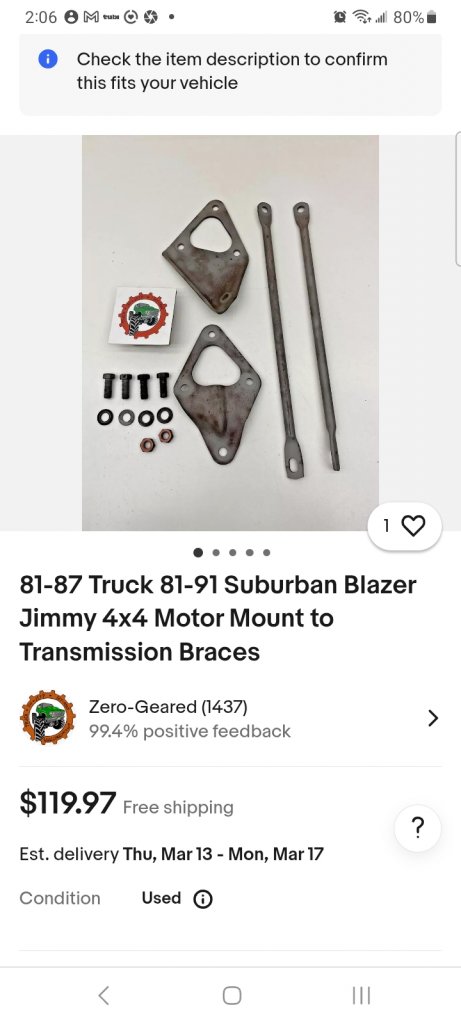

To help support the weight of having the transfer case behind the transmission.
They bolt to the motor mounts or crossmember or something like that?
6,424
10,958
Motor mounts to converter cover. Here's pics of some small block ones. May have to do mods or fab work to work on a big block.
