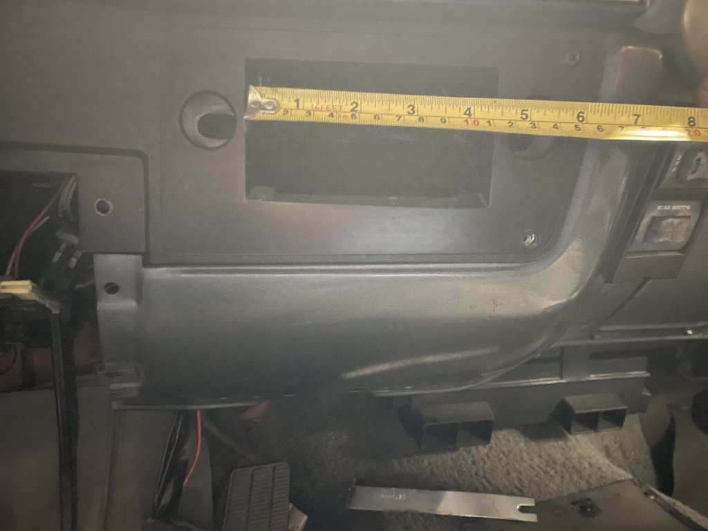

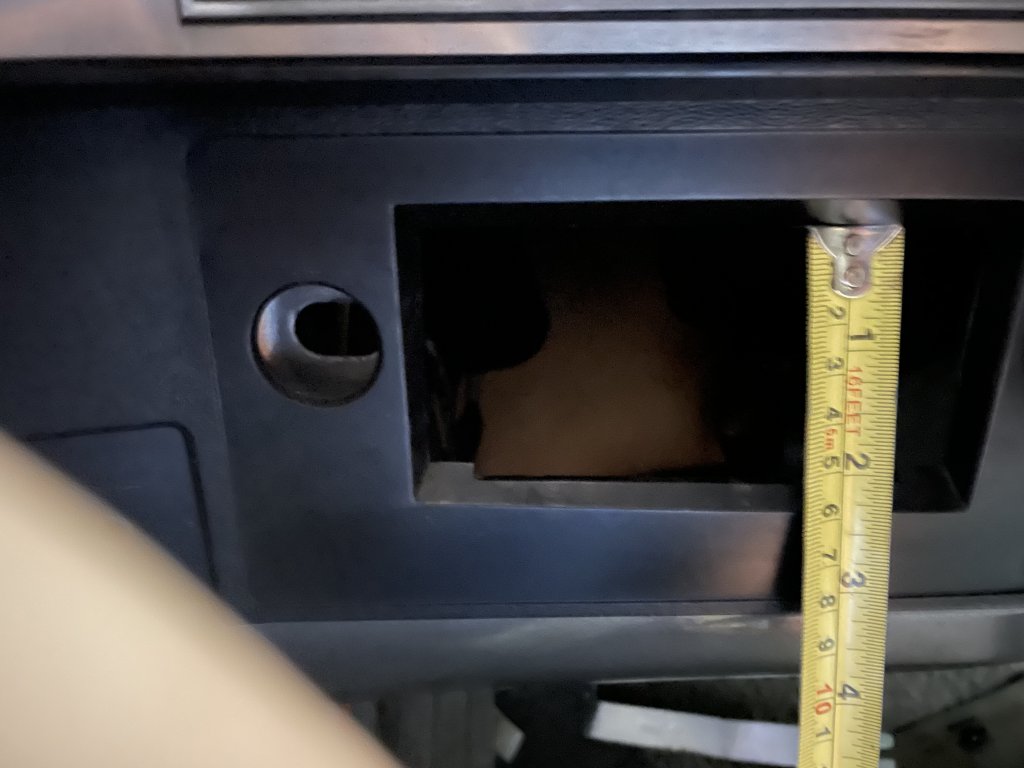

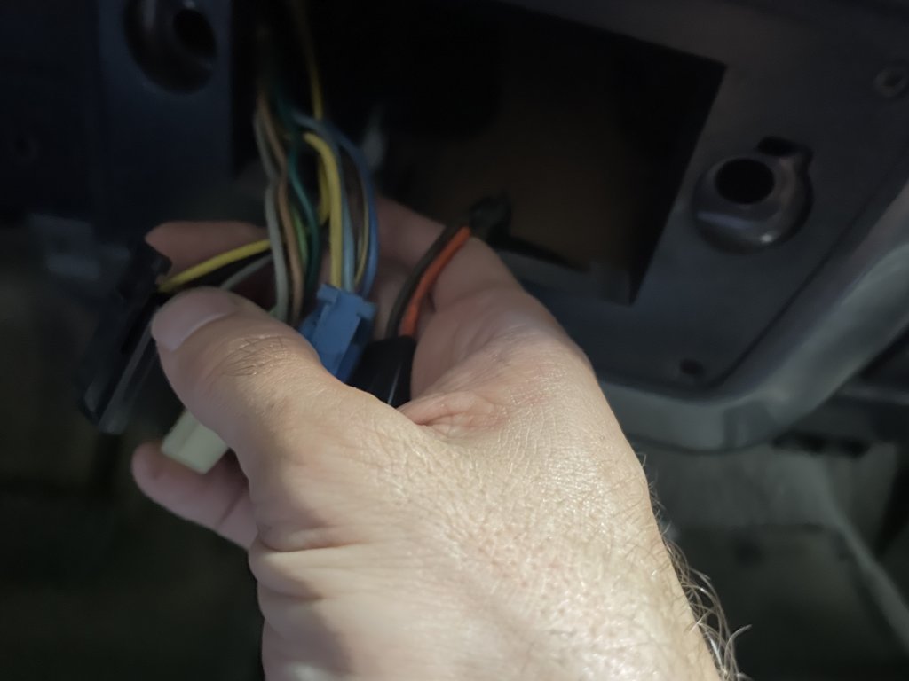

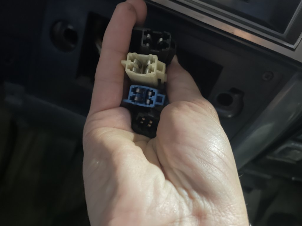

I am trying to order a RetroSound radio for my 88 Suburban. Does anyone know:
(A) which retrosound bezel fits this opening; and,
(B) which Metra (or other brand) harness adapter fits these connectors?
Thanks in advance. Pics are below.

With the exception of the constant memory plug (the smaller one), the conversion connector for GM vehicles through '89 is what you need.
For the constant memory wire, you will just have to put a spade on it and plug it into the factory connector.

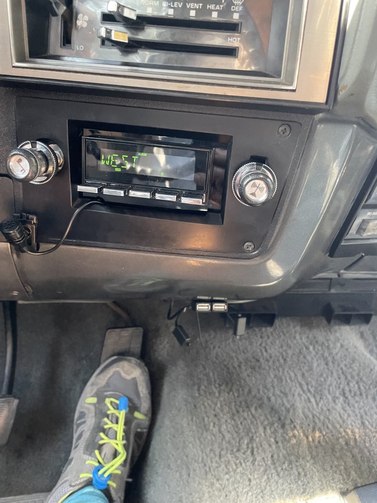

Closing the loop here, bucket was 100% correct. I ended up using an “add-a-fuse” tap on the “horn” fuse to get constant 12v power. Everything else was plug (er… solder) and play.

I have a Retro Sound Hermosa. I had to slightly file the sides of the OEM opening to get the outer sleeve to fit.
