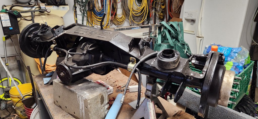

Photo didn't attach because I'm on my mobile...
